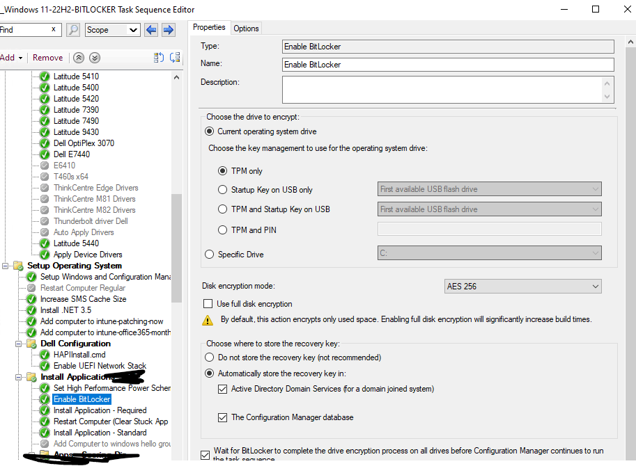

  3. Enable Bitlocker Windows 11 SCCM Task Sequence fails?
    We are trying to enable Bitlocker on few different Dell laptops. Currently it fails with these generic errors.
    What am I am I missing here?
    We deployed bitlocker via intune and that works well but trying to deploy this for imaging from the get go is a pain.
    From TS when its running.
    Running module version 5.0.9122.1000 from location 'C:\WINDOWS\CCM\OSDBitLocker.exe'
    Command line: "OSDBitLocker.exe" /enable /drive:C: /wait:True /pwd:AD_CM /full:False /crypt:4 /ignoretpm:True
    Initialized COM
    Command line for extension .exe is "%1" %*
    Set command line: "OSDBitLocker.exe" /enable /drive:C: /wait:True /pwd:AD_CM /full:False /crypt:4 /ignoretpm:True
    User specified valid encrypt method value: AES_256
    argInfo.keyMode != Key_Unset, HRESULT=80070057 (K:\dbs\sh\cmgm\1026_005344\cmd\7\src\client\OsDeployment\BitLocker\main.cpp,383)
    ProcessCommandLine( argInfo ), HRESULT=80070057 (K:\dbs\sh\cmgm\1026_005344\cmd\7\src\client\OsDeployment\BitLocker\main.cpp,477)
    Must specify '/mode' with '/enable'
    smsts.log after imaging.
