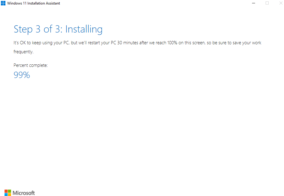

  3. The windows 11 installation assistant is stuck to 99% Installing
    Hello!
    I had a windows 10 and I was thinking it time to upgrade to windows 11 so I installed the windows 11 installation assistant and It did download already but now its stuck on 99% Installing
    Windows 11 installation assistant stuck at 99% eyOnjplB698WLmm8j%2fPnNWS7wKYmlC7IdJuZwTTe7Zjgtn9DpCuDc4tLGnEkAF8VKxUGoE%2fUboNseJEwiTizvzdt0%3d.png
    Omar Abdullah1, Oct 13, 2023

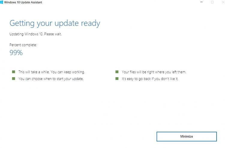

  4. Windows 11 installation assistant stuck at 99%
    Windows update assistant stuck at 99%
    This is what I see, and have seen since 7 am it is now almost 11 am.
    I already had 10, just needed the updated version.
    I said that about my wifi because microsoft keeps telling people to use a wired connection.
    Windows 11 installation assistant stuck at 99% 165241d1511452356t-windows-update-assistant-stuck-99-a-updatepdate.jpg
    dacholiday, Oct 13, 2023
