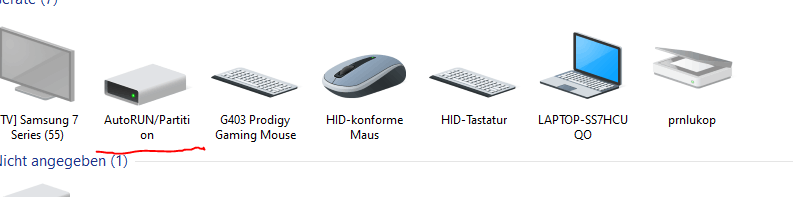

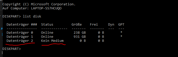

    Hi guys
    So, I basically downloaded the Windows 11 Media Creation Tool from the Windows 11 download site. I ran it and selected an 8GB USB stick (2.0) as the device that should be made into a bootable USB flash drive. It fully downloaded Windows 11 and then started creating... and then the tool worked until like 40%. Suddenly, the following error appeared: "There was a problem running this tool. We're not sure what happened, but we are unable to run this tool on your PC. If you continue experiencing problems, reference the error code when contacting customer support. 0x80042405 - 0xa001a".
    After that happened I could not access my USB drive anymore as an USB drive. It acts like a DVD drive. I can't format it. I can't use the automatic "Solve problems" stuff in explorer. I tried uninstalling the USB drivers and restarting and basically every suggestion. I don't see the drive in EaseUS Partition Master or AOMEI Partition Assistant, which is another problem because those tools could help me if I could see the USB drive there. My friend doesn't even see the USB drive on her MacOS. (I'm using Windows 10).
    In the screenshots, you can see the three places in the OS where the USB is still "visible". I can see the USB drive in the "disk part"-tool from Windows. I can select it there, but I can't use the "Clean" command or anything. So, because the drive is visible I think it is not broken. It reacts to some commands (like eject). The Media Creation Tool did something to the USB drive (made it into an AutoRUN thing) and now I can't do anything with it.
    Windows 11 Media Creation Tool error leading to USB drive problem.... e4dbda14-4fc4-4b31-a75b-d8462185754d?upload=true.png
    Windows 11 Media Creation Tool error leading to USB drive problem.... 0417b5e9-c4ba-4f8a-b1a2-a7d9f470d1de?upload=true.png
    Windows 11 Media Creation Tool error leading to USB drive problem.... f6614b9c-de30-49b2-9efc-5f8f59a6b465?upload=true.png
    RobertMusil, Apr 22, 2024
