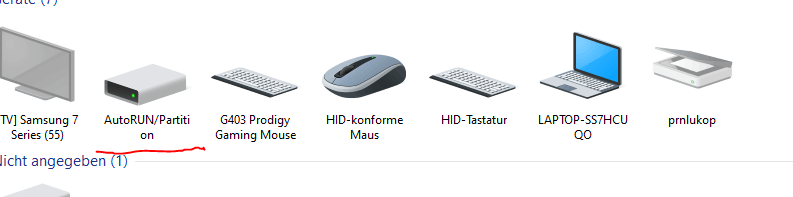

    So, I basically downloaded the Windows 11 Media Creation Tool from the Windows 11 download site. I ran it and selected an 8GB USB stick (2.0) as the device that should be made into a bootable USB flash drive. It fully downloaded Windows 11 and then started creating... and then the tool worked until like 40%. Suddenly, the following error appeared: "There was a problem running this tool. We're not sure what happened, but we are unable to run this tool on your PC. If you continue experiencing problems, reference the error code when contacting customer support. 0x80042405 - 0xa001a".

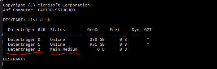

    After that happened I could not access my USB drive anymore as an USB drive. It acts like a DVD drive. I can't format it. I can't use the automatic "Solve problems" stuff in explorer. I tried uninstalling the USB drivers and restarting and basically every suggestion. I don't see the drive in EaseUS Partition Master or AOMEI Partition Assistant, which is another problem because those tools could help me if I could see the USB drive there. My friend doesn't even see the USB drive on her MacOS. (I'm using Windows 10).
    In the screenshots, you can see the three places in the OS where the USB is still "visible". I can see the USB drive in the "disk part"-tool from Windows. I can select it there, but I can't use the "Clean" command or anything. So, because the drive is visible I think it is not broken. It reacts to some commands (like eject). The Media Creation Tool did something to the USB drive (made it into an AutoRUN thing) and now I can't do anything with it.

    My first step was to examine the setupact.log file that the Media Creation Tool has created: the error was from the CDIpActionLayoutUsb:Windows 11 Media Creation Tool error leading to USB drive problem.... :prepareUsbMedia which by the way did not appear in the other file (???). The
    logic told me that the problem was in the pen drive format: partition, disk, volume ? In short, the Format command and the Disk Management tool didn't seem to work and after much test the solution was the DiskPart Windows tool. Here is how to insert it into
    the procedure:
    • Attach a formatted USB pen to the PC;
    • Start the Media Creation Tool, do the all steps until the download of the files starts (You must select first the USB pen disk);
    • And now the magic DiskPart tool:
      • start it;
      • By the LIST VOLUME command identifies the volume of the USB pen and remember the attached number;
      • Select it by the SELECT VOLUME <number>
      • Now use the command CLEAN
      • Enjoy the end;
    I don't know why, by this last command permits the Media Creation Tool to complete and create the bootable USB pen correctly. I've tried the procedure 3 times and all works well.
