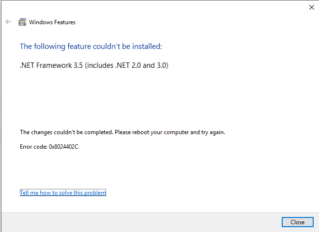

  3. Error Code 0x8024402c windows 10 when installing .net framework 3.5
    Hi, is there anyone know how to solve Error Code 0x8024402c windows 10 when installing .net framework 3.5?
    Windows 11: .NET Framework 3.5 Offline installer Stops with Error Code 0x8024402c. 14fd6ff1-0b55-44a9-9e03-53df720a50e3?upload=true.png
    I've Tried so many method but none of them works.
    Thanks.
    William Santoso, Feb 3, 2025
