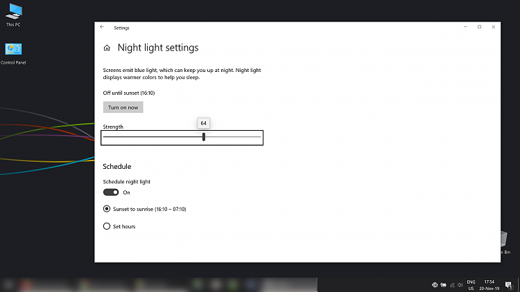

  3. Night Light won't turn on on schedule
    Night Light won't get activated on schedule - see screenshot for details. Deactivation works as expected though.
    OS version: Windows 10 1909, but before upgrading from 1803 I experienced the same problem
    Intel GPU driver version: 26.20.100.7463
    Night Light works as expected on my desktop, with seemingly the same programs being installed and the same Windows settings (related to Location, Time etc.)
    Any idea what is wrong and how it can be diagnosed?
