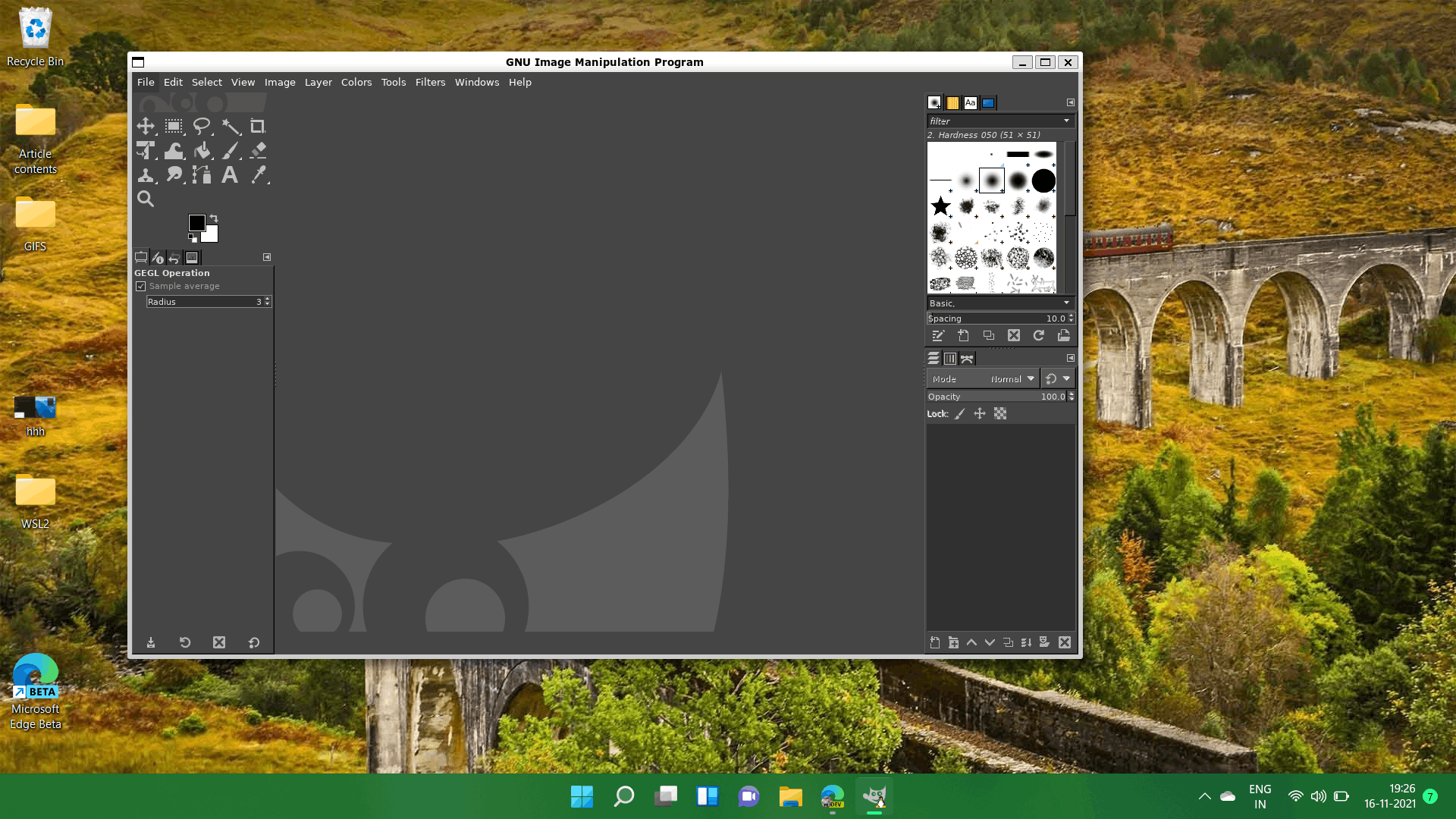

    GIMP running on Windows 11 installation, courtesy of WSLg

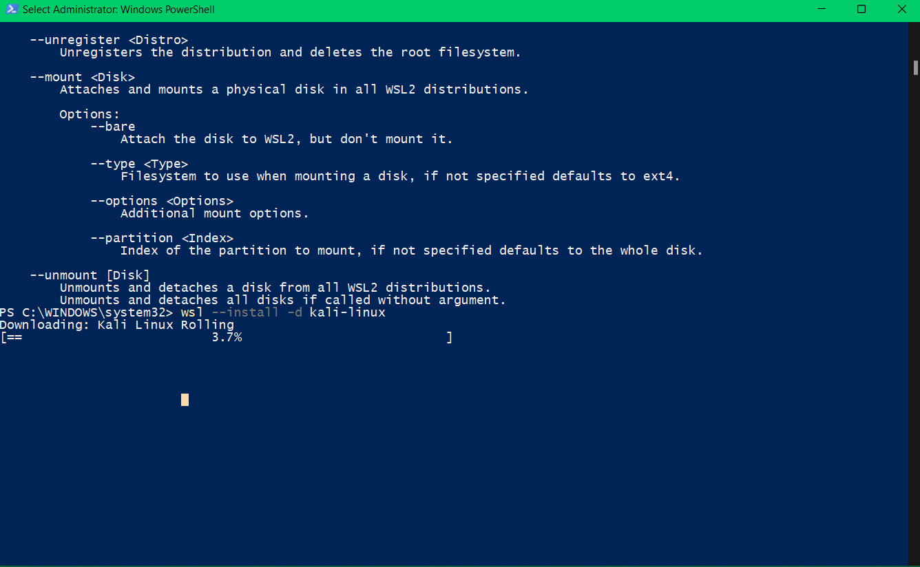

    The installation of WSL is pretty simple:
    1. In the Run Dialog box, type powershell.exe and press Ctrl+Shift+Enter, to run it as elevated.
    2. Execute the command: wsl --install
    3. This command would automatically enable required optional features and Install the default distribution Ubuntu for you.
    4. If you want to change the default distribution, use the -d switch. For Example, to install Kali Linux, use wsl --install -d kali-linux
    Windows 11 + non-signed Linux distribution on separate drives c56a1465-ff12-4c0f-b36f-d2aefcbab209?upload=true.png
    WSL installing Kali Linux

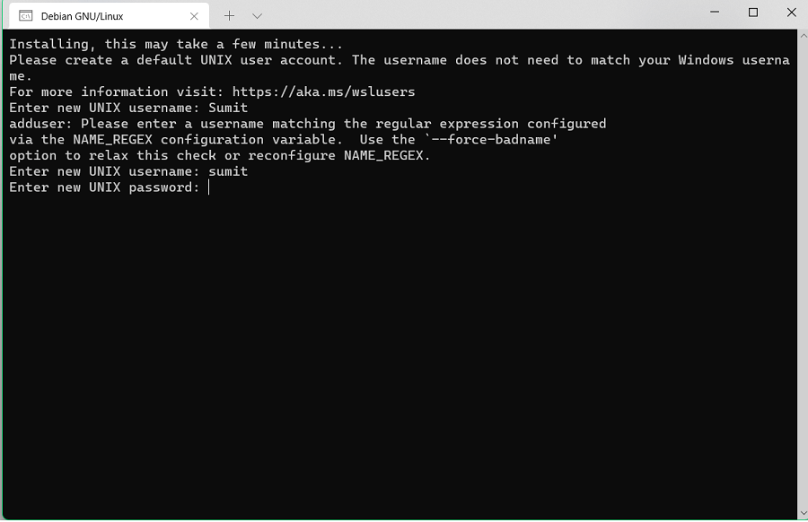

    Setting up WSL for first use
    1. After the WSL distribution download is complete, you would need to configure it. Afterward, when the download is done, open the distribution from the start menu.
    2. Now, the next step is to set up a username and password for opening the Distro. Enter your desired username and password, and press Enter. The username should be in small letters.
    3. You would see username@PCName in the command line, waiting for a command.
    4. Enter sudo apt update && sudo apt upgrade command to update the Distro with the latest packages.

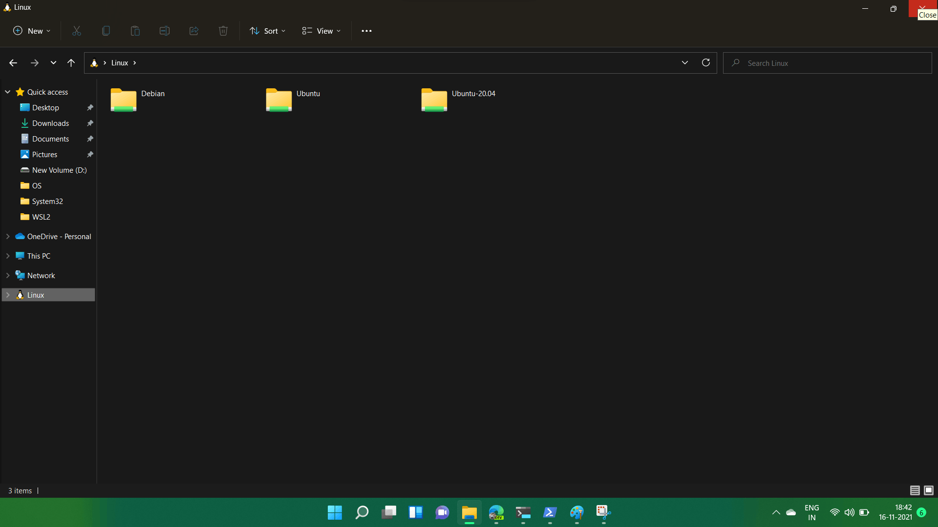

    Navigating with files
    When the Distro is installed, Windows would add an option in the File Explorer so that you can directly access the files.

    Run GUI Apps in WSL
    If you are running Windows 11, you can run Linux GUI apps natively on Windows 11. See the steps below
    1. Make sure the latest GPU drivers are installed from the GPU manufacturer.
    2. If you had set up a Linux distribution before, you would need to update WSL to support GUI. For the same, execute wsl --update in an elevated Powershell. You can also check for Windows updates.
    3. The next step is to download the specific app. Some of the widely used GUI apps on Linux can be installed using the commands below:
      1. GEDIT: sudo apt install gedit -y
      2. GIMP: sudo apt install gimp -y
      3. VLC: sudo apt install vlc -y

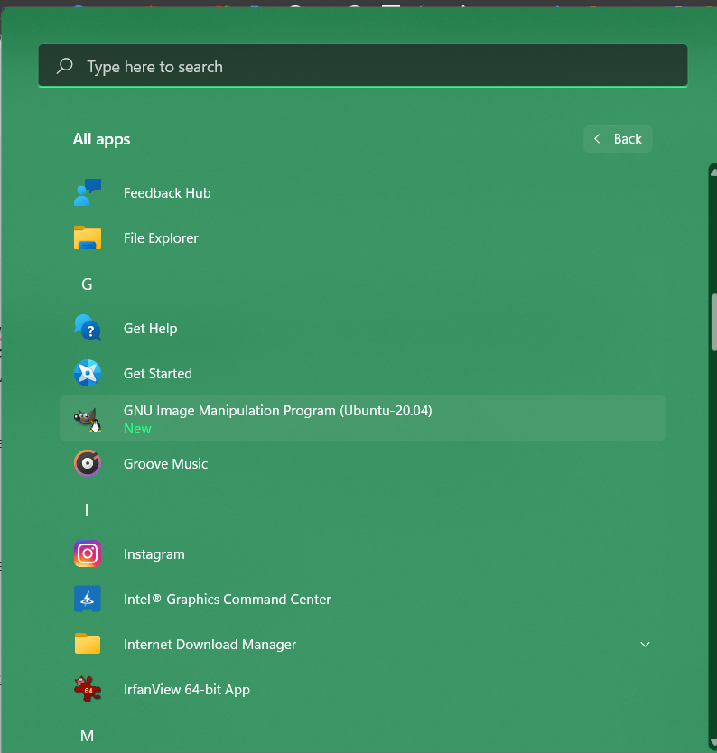

    Additionally, other apps, which the package manager does not support, can be installed by downloading a Debian package and the Command line. For Example, for Edge, see the steps below:
    Download Microsoft Edge Insider Channels
    For Microsoft Teams:
    1. Swap directories into the temp folder: cd /tmp
    2. Use the curl command to download the package: sudo curl -L -o "./teams.deb" "https://teams.microsoft.com/downloa...x&arch=x64&download=true&linuxArchiveType=deb"
    3. Use the apt command to install it: sudo apt install ./teams.deb -y
    When the installation is complete, you will see the app listed in the Start menu. You can also cycle between apps using Alt+Tab as well.
