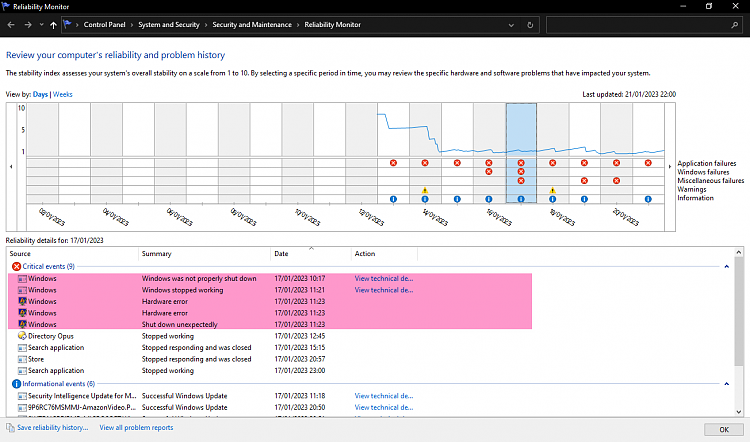

    The ratio is 0.63 However a new power plan was delivered to my computer, probably from Windows Update.
    Windows 11 "Reserve battery level" warning is broken ween-second-low-battery-notification-hibernation-windows-unexpected-shutdown-reliability-monitor.png
    It was probably due to what happened on my 5th day of using my laptop, following an unexpected shutdown from 2 weeks ago, when the laptop was attempting to hibernate whilst it had ran completely out of battery before it had the chance to fully hibernate, in the midst of lots of programs running at the same time (as well as a 2.4GHz wireless mouse).

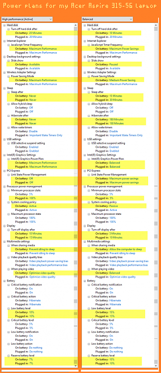

    Windows 11 "Reserve battery level" warning is broken ime-between-second-low-battery-notification-hibernation-power-plans-my-acer-laptop-aspire-315-56.png
    The one on the right is what Windows Update gave me (within the last 2 days, most likely today). Before there was only one power plan. The only changes I had made was
    • Low battery level: 10% before and 15% after
    • Reserve battery level: 7% before and 10% after
    • Critical battery level: 5% before and after
    I'll switch from the high performance plan to the balanced plan, to see if that helps, after a few weeks. Update: 2 weeks later
    • Low battery level: 17% (+2)
    • Reserve battery level: 14% (+4)
    • Critical battery level: 7% after (+2)
    Update: Another 2 weeks later
    • Low battery level: 19% before (+2)
    • Reserve battery level: 15% (+1)
    • Critical battery level: 7% (no change)
    • Low battery level: 22% before (+3)
    • Reserve battery level: 17% (+2)
    Update: 1 week later (for when bluetooth is on)
    • Low battery level: 22% (no change)
    • Reserve battery level: 17% (no change)
    • Critical battery level: 9% (+2)
    • Low battery level: 27% (no change)
    • Reserve battery level: 15% (no change)
    • Critical battery level: 11% (+2)
    • Low battery level: 37% (no change)
    • Reserve battery level: 25% (no change)

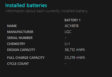

    Windows 11 "Reserve battery level" warning is broken t-extending-time-between-second-low-battery-notification-hibernation-draining-battery-capacity-1.png
    22nd of January: 0.63 30th of April: 0.49 So it continually declines by approximately 0.14 every 4 months. The weird thing I've noticed is that the lower the current battery charge is, the faster the current charge gets depleted.
