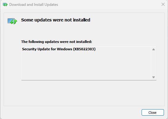

  2. windows11.0-kb5022303 fail to install
    1. trying to install via windows update fails with error: Some update files are missing or have problems. We'll try to download the update again later. Error code: (0x80073712)
    2. tried to fix with windows 11 update KB5022303 will not install - fails.
    3. direct download and install from here: Microsoft Update Catalog - fails with error:
    Windows 11 Update KB5022303 fails to install 7a007d0e-ca2a-44d3-9b01-95b3e4b46cb3?upload=true.png
    please advise
    BatedToast26434, Jan 20, 2023
