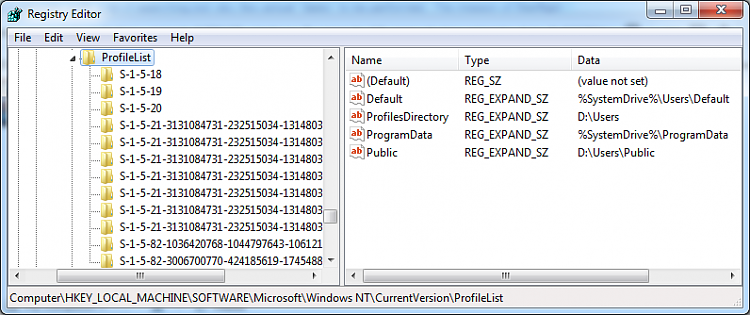

    Yes, I moved the profiles folder from C:\Users to to D:\Users to preserve the life of my SSD drive. However, I did the same in my laptop and I succeeded in migrating it to W10.
    This is a snapshot of the ProfileList registry key in my W7 desktop PC
    Windows 11 upgrade fails at first_boot migrate_data 0x8007001f 0x3000d 326095d1617656999t-windows-7-upgrade-10-error-during-migrate_data-0x8007001f-0x3000d-profiles_w7.png

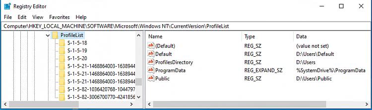

    And this is the same registry key in the laptop that was successfully upgraded to W10
    Windows 11 upgrade fails at first_boot migrate_data 0x8007001f 0x3000d 26096d1617657101t-windows-7-upgrade-10-error-during-migrate_data-0x8007001f-0x3000d-profiles_w10.png
    What about the "A device attached to the system is not functioning" error in the log file? Is there a way to know which device the installer was complaining about?
