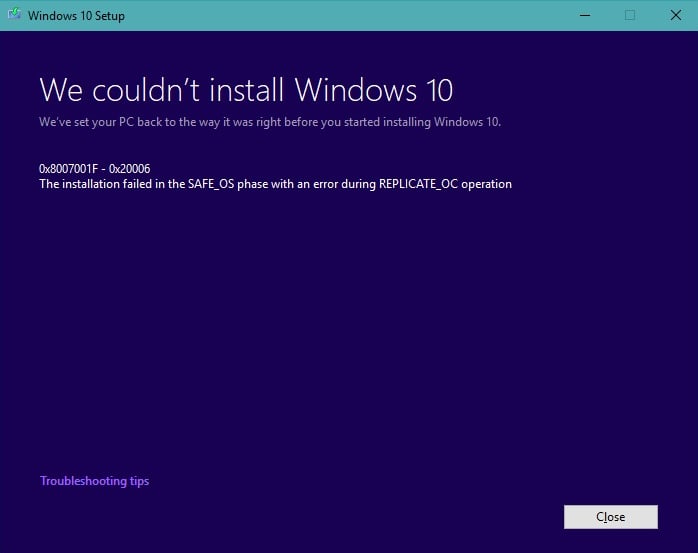

  3. Windows 10 Update keeps failing 0x8007001F - 0x20006
    I would not be posting here, if it weren't because I've tried everything I can think of. I know that there is similar threads, but I have tried the suggested solutions in nearly all of them, so I am making a new one, in the hopes that someone can give med a clue on whats causing this.
    What I am trying to do
    I am trying to update windows 10 to 1709 (the Fall Creators Update) and now, 1803 (Windows 10 April 2018 Update)
    System information
    I am currently on Windows 10 Pro 64bit Version 1607 (operating system build 14393.1593) desktop pc
    CPU: Intel Core i7-4790K Devils Canyon (4th Generation Intel® Core™ i7 Processors)
    Motherboard: ASUS Z97-PRO GAMER
    GPU: NVIDIA EVGA 1080 SC
    SSD for C: drive, HDD for ekstra drive.
    The installation error
    I'm getting the following error message: "the installation has failed during SAFE_OS with error in operation REPLICATE_OC"
    With the error code: "0x8007001F - 0x20006". Screenshot:
    Windows 23H2 Update keeps failing to install 0x8007001f / 0x80242016... but already installed. 205696d1526960675t-windows-10-update-keeps-failing-0x8007001f-0x20006-0x8007001f-0x20006-error.jpg
    Furthermore I found a useful tool from Microsoft called SetupDiag which concludes this is the issue:
    Code:
    Interestingly I sometimes get this SetupDiagResults.log instead with the extend code 0x50015: SetupDiagResults.log - Pastebin.com
    For the record I have tried to "set Windows Modules Installer" service (Trusted Installer) to automatic start, reboot and tried the update again" multiple times.
    The logs
    C:\Windows\Logs\CBS\CBS.log for today: CBS.log - Pastebin.com
    C:\$WINDOWS.~BT\Sources\Rollback\setuperr.log C:$WINDOWS.~BTSourcesRollbacksetuperr.log - Pastebin.com
    C:\$WINDOWS.~BT\Sources\Rollback\setupact.log C:$WINDOWS.~BTSourcesRollbacksetupact.log - Pastebin.com
    The logs SetupDiag collected as a zip file: Deleted
    Recent windows updates: Windows update recent log - Pastebin.com
    What I have tried so far
    I have tried the following ways to update for the past 5-8 months:
    • Downloaded media creation tool and tried to upgrade with it
    • Created a .iso file, mounted it and tried to update with it
    • Created a USB installer with the media creation tool and tried to update with it
    • Tried updating with windows update (built in)
    • Tried updating with windows update assistent which got installed automatically (by windows update?)
    • Tried updating by downloading and installing windows update assistent manually
    • Tried many different combinations of choosing to install updates and not
    Windows fails every time with the before mentioned error.
    I have also tried "repairing my system" in multiple ways:
    • Reinstall built in windows 10 apps using powershell:
      Code:
    Full log: Powershell reinstall built in apps - Pastebin.com
    Furthermore i did steps to minimize risk of failure:
    • Removed all unnecessary hardware (except mouse and keyboard)
    • Uninstalled my Anti Virus
    • Updated my network drivers, graphic drivers, audio drivers
    • Disconnected from the internet while updating
    So to my questions now:
    Question 1)
    What exactly is SetupDiag suggesting here?
    Code:
    Question 2)
    If you are a talented technican, can you tell me anything helpful on what is causing the update to fail from looking at the logs?
    Please don't suggest a clean install, as I already know this is a option, but in my case, almost impossible to do.
    Ten4TheWin, Mar 9, 2024
