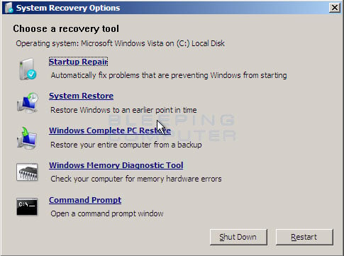

    These are the choices using a disk:
    Windows 7 startup repair cannot repair this computer automatically advanced-recovery-options.jpg
    Figure 9. Vista System Recovery Options screen
