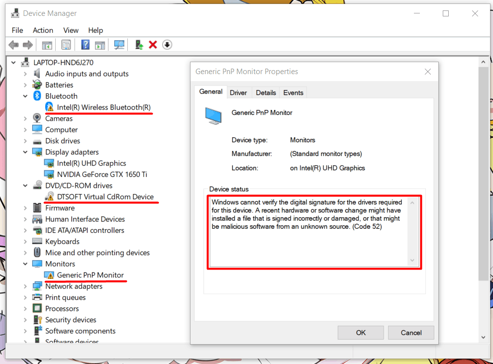

  4. HasegawaY Win User
    Windows cannot verify the digital signature Code 52
    Windows cannot verify the digital signature for the drivers required for this device, error code 52
    I get this error after my keyboard broken and install some driver to fix my keyboard . . . but after i do, i got error code 52 for my monitors, bluetooth, and DVD/CD Rom Drivers. My windows is Windows 10 Home . . . . I've been looking for various ways to solve it until I did a system restore to the last checkpoint because frustrate, but it still can't be fixed until now . . . . My Device is ASUS TUF F15 and few weeks ago it's still normal to use, still work on windows 10 Home . . . I've tried to turn off integrity and still can't. . . I have tried to Disable Driver Signature Enforcement from the boot menu and it worked but in some applications get abnormal environment and the helper says if this is because I have Disabled Driver Signature Enforcement
    Windows 64bit and i do download some drivers to various official sources according to the instructions from the internet but it still fails and always gives a message
    Windows cannot verify the digital signature for the drivers required for this device. A recent hardware or software change might have installed a file that is signed incorrectly or damaged, or that might be malicious software from an unknown source. (Code 52)
    Windows cannot verify the digital signature Code 52 41f47fb4-103d-4e7b-afa7-da991f79b344?upload=true.png
    Please help me . . . .
    HasegawaY, Sep 27, 2023
