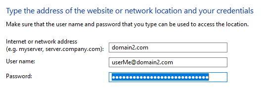

    I would like to set up a windows credential manager entry that substitutes my credentials when connecting to any server or resource (SQL instance, web sites, fileshares, etc) in another domain.
    For example, let's say I normally log into my laptop with "domain1.com\userMe". I want to be able to connect to two different SQL Server instances "SQLServer1.domain2.com, 1433" and "SQLServer2.domain2.com, 1433" using Windows authentication. I have an AD user in domain2.com called "userMe" that has permissions to both SQL instances.
    I would like to set up a Credential Manager Windows credential on my laptop in domain1.com, which maps "domain2.com" to "*** Email address is removed for privacy ***" with my password, so any time I connect to any SQL instance, website, or fileshare in domain2.com, it automatically maps my login to *** Email address is removed for privacy ***. It would look like this:
    Windows Credential Manager - authenticate for entire domain instead of just one server 75296c78-e1f8-42a6-a608-181af7ff1c5b?upload=true.png
    Is this supported? I have tried it, and it works for some resources (SQL Server), but not others (websites and fileshares).
    e-a-m, Feb 5, 2019
