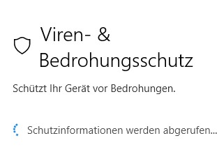

    We're running a non-persistent VDI pool with FileShares as the definition update source. This has been working fine until we added the Startup script which onboards the VM's into Azure Defender Security Center. I've used the powershell 'single entry' method described here:
    Onboarding VDI devices
    However, the child VM's are no longer displaying their status or last update time - the engine just egg timers and the log file mplog.log shows these entries:
    Windows defender VDI onboarding to Security Center and now VM's don't display defender... 39f8191e-0235-460a-9340-d30209598392?upload=true.jpg

    I don't understand what the enrolment does - I assumed it juust makes the VM's manageable /report into Azure, but it appears to change the way they fetch updates? Any help on this please?
