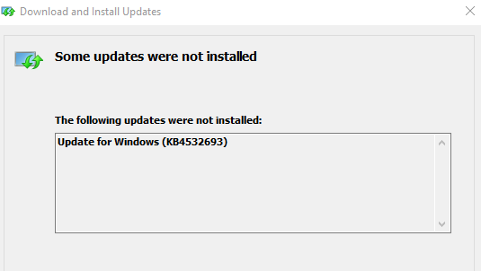

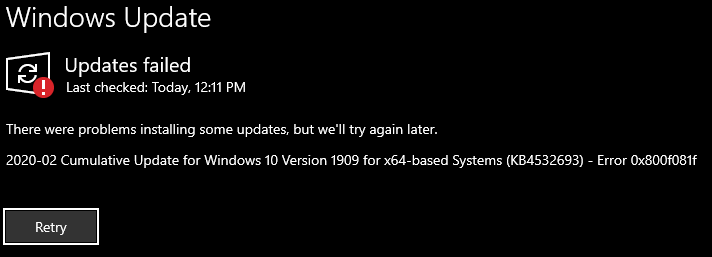

    I get this error when attempting to install KB4532693.
    Windows Error: 0x800f081f when installing update KB4532693 5547fc20-b262-46af-8ed9-5bf47fdca762?upload=true.png
    Also installing via the .msu file itself
    Windows Error: 0x800f081f when installing update KB4532693 ff9ed06f-a016-4522-8096-f84cbf9c62e4?upload=true.png
    It looks like the Microsoft Suggestion here is as follows:
    https://support.microsoft.com/en-us/help/2734782/net-framework-3-5-installation-error-0x800f0906-0x800f081f-0x800f0907
    https://docs.microsoft.com/en-us/wi...ure/desktop/configure-a-windows-repair-sourceI am unsure about this resolving the issue and am wondering what it could be. I should have the sufficient privileges and this is a clean install of Windows 10 Pro 1909.

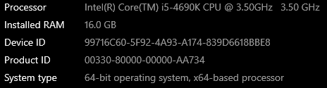

    Running the latest BIOS etc on this hardware:
    https://www.newegg.com/p/N82E16813157526?Item=N82E16813157526
    https://www.newegg.com/intel-core-i5-4th-gen-core-i5-4690k/p/N82E16819117372
    https://www.newegg.com/samsung-860-qvo-series-2tb/p/N82E16820147739
    I don't believe I've had an issue with a Windows 10 update like this before, what could be the root cause/fix to this issue?

  4. davidhk Win User
    Error 0x800f081f in Win 10
    In case you have any doubt, here is the article issued by Microsoft..................
    https://support.microsoft.com/en-us/gwt/10164
    direct copy from the article...................... ( this method is applicable to Windows 10 )
    Solution for error 0x800f081f for Windows 8.1 or Windows 8
    If you receive Windows Update error 0x800f081f, it means that Windows Update cannot determine the cryptographic service provider, or a file that Windows Update requires (named catalog store) is corrupted.
    To resolve this problem, follow these steps:
    Step 1: Use System File Checker to repair damaged Windows files
    Use the System File Checker tool to repair damaged Windows files, and then run Windows Update again. To do this, follow these steps:
    • Open an elevated command prompt.
    • Run the following command:
      sfc /scannow
    • Try to install update again.
    For more information about the System File Checker tool, view Use the System File Checker tool to repair missing or corrupted system files.
    Step 2: Run the DISM tool
    If the problem continues, use the Deployment Image Servicing and Management (DISM) tool to fix Windows corruption errors. To do this, follow these steps:
    • Run the following command: DISM.exe /Online /Cleanup-image /Restorehealth.
    Important When you use the /online option, DISM uses Windows Update to provide the files that are required to fix corruptions. However, if Windows Update service is broken, don’t use the /online option. Instead, use a running Windows installation as the repair source, or use a Windows side-by-side folder from a network share or from a removable media, such as the Windows DVD, as the source of the files. To do this, run the following command instead:
    DISM.exe /Online /Cleanup-Image /RestoreHealth /Source:C:\RepairSource\Windows /LimitAccess
    Note Replace the C:\RepairSource\Windows placeholder with the location of your repair source. For more information about using the DISM tool to repair Windows, reference Repair a Windows Image.
    To learn more about this tool, go to Fix Windows corruption errors by using the DISM or System Update Readiness tool.
