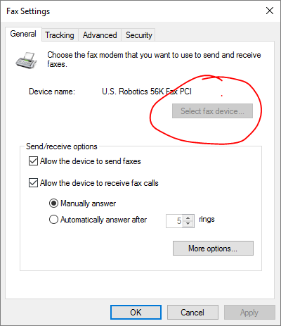

  4. Windows Fax and Scan does not recognize my fax modem.
    Fax and Scan does not recognize my Modem
    Windows Fax and Scan does not seem to recognize that my modem is a fax modem.
    W10 Pro 10586
    Modem: US Robotics 56K Fax PCI (Internal Modem)
    The modem worked on this computer running Windows 7
    I don't recall if I've tried it since installing W10.
    This was a clean install of W10.
    There is a Fax printer in Devices and Printers.
    I can start WFS
    Navigate to Tools/Fax Settings
    Although the Device name is present, the option to "Select Fax Device" is grayed out.
    Windows Fax and Scan does not recognize my fax modem. a88851cb-1afd-432b-9c1a-458e74da4d38.png
    If I select OK, WFS continues to be unable to send a Fax

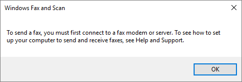

    If I navigate to Tools/Fax Accounts/Add Account, it tells me I need to Connect to a Fax Modem. If I go through the options, choosing the defaults to try to attach a modem, although it seems as if it might be connecting, I eventually get to an error message
    telling me I need to connect to a Fax Modem:
    Windows Fax and Scan does not recognize my fax modem. 22cae1ea-ed41-4c4d-a497-4b879a67b8dd.png
    And if I continue, the program will eventually become non-responsive.
    • I could not find anything relevant in the Event Viewer, but I might not be looking/searching in the right place.
    • I have disabled, rebooted, and re-enabled the Windows Fax feature
    • I have removed and re-installed the modem in Device Manager
    • I have physically removed, cleaned, and reseated the modem card
    • I have executed the modem diagnostics in Device manager with no errors reported
    • I can make telephone calls from Outlook 2016
    • And, as I wrote above, this card did work when I was running Windows 7
    Any help/suggestions much appreciated.
