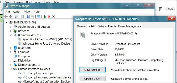

    Turning to your device manager. Please post a screenshot like this:
    Windows Hello Fingerprint Login Suddenly Says Its Unavailable 339955d1625762781t-windows-10-fingerprint-sign-suddenly-unavailable-1.jpg

    Have you checked your Device Manager - is the driver installed correctly (the above screenshot will tell us).
