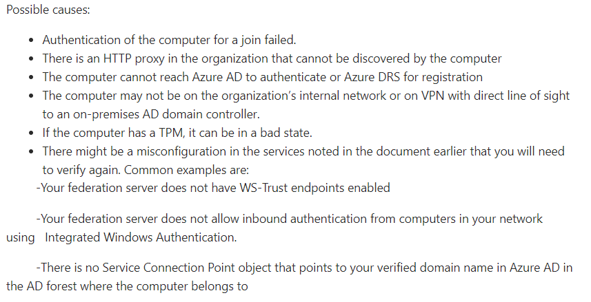

  3. Event ID 360 errors
    Dear PatrickWoehl
    Hope you are doing great.
    As described in the thread below, there are many reasons involved in this event ID 360, please refer to the list of reasons in the following thread, which are all worth checking
    Event ID 360 and 362 Windows Hello For Business does not provision
    Windows Hello for Business is STILL getting the EVENT 360 during startup, event after... 30f84c69-a6d7-4884-90e0-606bf3ede9d1?upload=true.png
    According to the error event 360, one of the above reasons was trying to register this device all the time. Disabling this key can fix this problem
    Chandy - MSFT, May 21, 2025
