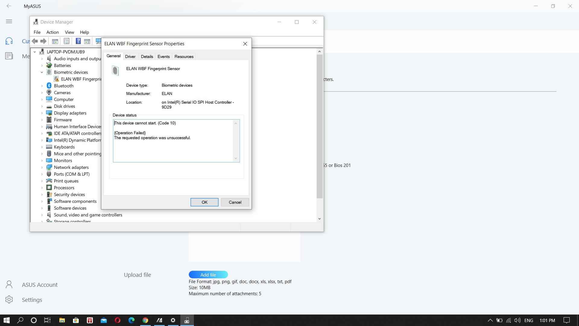

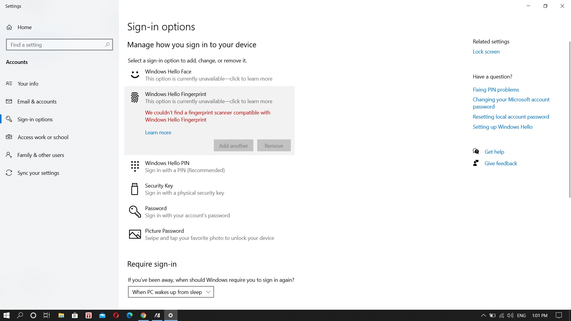

    im using asus s510unr model, form the past 20days my fingerprint is not working after i updated the windows which has pop-up 20days back.
    in signin setting it is showing this option is currently unavailable.
    i have tried
    1. updated to the latest version in asus web site
    2. reinstalled the driver
    3.disabled and enabled
    4. factory reset also done
    tried all those things but couldn't resolved
    can you please help windows hello sign in fingerprint is not working 9519612a-a123-433b-9e92-f6dce053b44f?upload=true.jpg windows hello sign in fingerprint is not working 5dd51b82-b936-44f8-be53-afa8eda588fa?upload=true.jpg

  3. Windows Hello Fingerprint not working
    This is still not working after doing all those steps, please help after the Windows update it stopped working and it says the following : we couldn't find a fingerprint scanner compatible with windows hello fingerprint.
    After taking all the steps you suggested on here it says i have the latest update.
    MildredMorales2, Jul 9, 2020
