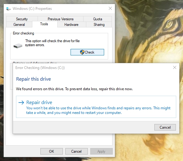

    It has been around two weeks since my laptop started to do an automatic check on my C: drive every startup, but somehow it never proceeds to actually check it it skips right away to the lock screen. I find this really odd because I have not force-shutdown my laptop for--at least--the last 6 months. Besides, I am pretty sure that this is not the first time my laptop did a disk check during startup, and when it does, it always continues until the process is 100% done
    1st attempt of fixing this: Using the check disk tool in my C: drive's Properties menu
    Windows keep running chkdsk on my C: drive during startup, but always skips the process b1027e6b-7872-4aa8-ad96-ddef6fb25350?upload=true.jpg
    So I went to check my C: drive Properties and click on the "check" button in the "Tools" tab, and--as expected--it says that there are errors in my C: drive and I have to repair it, but I soon figure out that it is not possible to fix a C: drive while I am using the computer, thus, the repair can only be done during startup, but as always, when the system scans my C: drive during startup, it never actually complete the process,

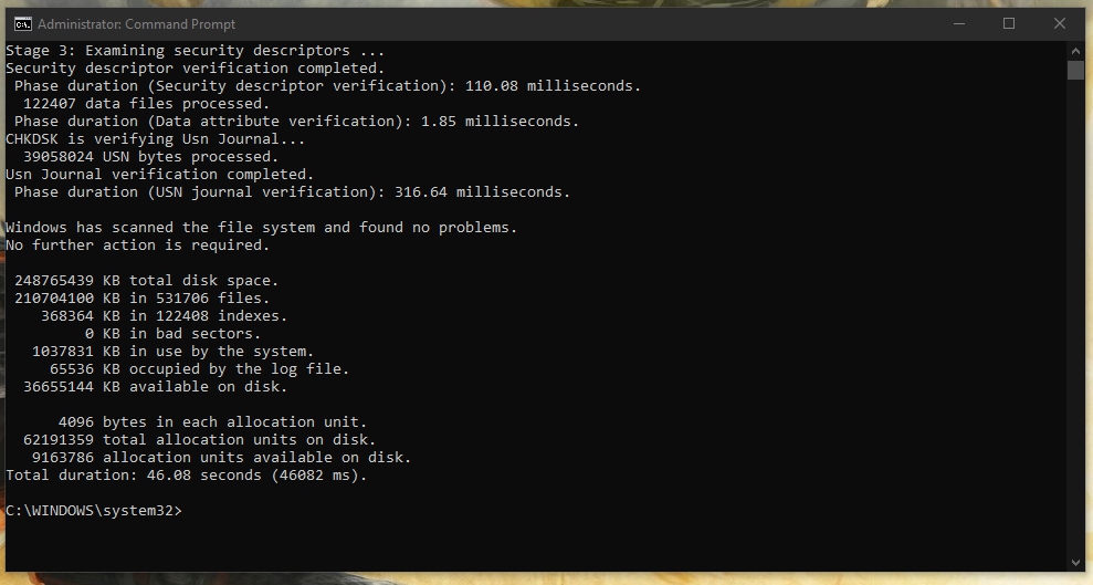

    Running the "chkdsk" command in a read-only mode
    Windows keep running chkdsk on my C: drive during startup, but always skips the process 7a292801-51f0-49e7-92ec-7e6acbb752a6?upload=true.jpg
    I then tried to run the chkdsk command in a read-only mode without /f or /r and oddly, it says that "Windows has scanned the file system and found no problems. No further action is required", contrasting to what the system says when I checked the disk in the Properties menu. This is the same result as when I ran chkdsk to my D: drive which I'm certain, is healthy, bcs previously I've checked my D: drive in the Properties menu and it also said that there's no error found in it.
    Long story short...
    ...when I checked my C: drive in the Properties menu, in the Tools tab, it says that there are errors in my disk, but when I ran the chkdsk command with cmd, it says otherwise, which leaves me with confusion on whether or not there is actually something wrong with my C: drive.
