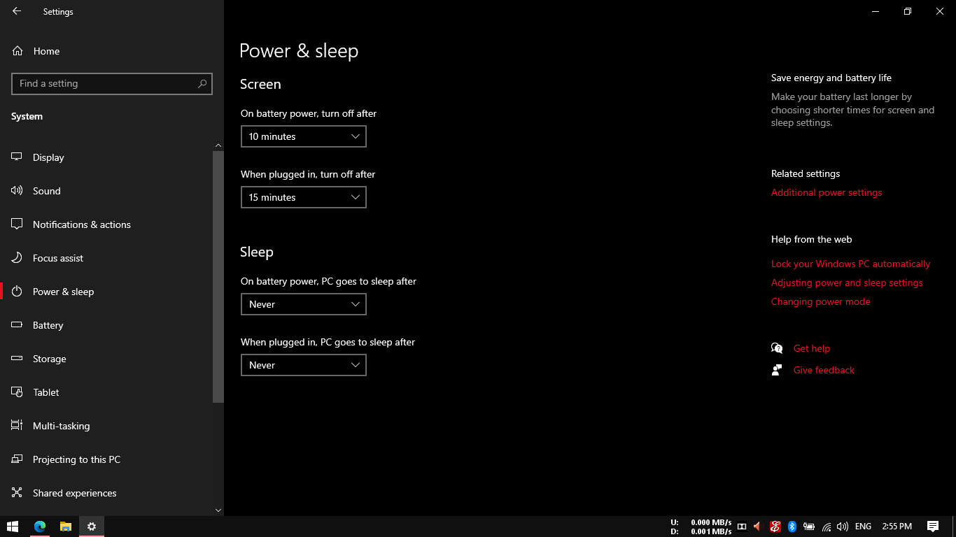

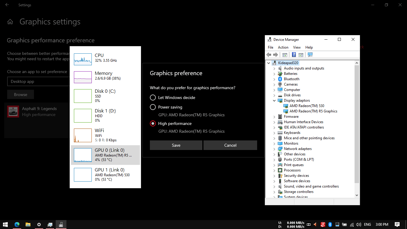

  4. Windows not detecting IGPU and descrete GPU in Graphics Preference
    Graphics Performance Preference shows only iGPU
    I have tried updating my driver and uninstalling it, letting WINDOWS update it automatically (also updated windows in this process to 22H2). I am not able to get the third solution as there is no "Change power settings that are currently unavailable" in the options, I have attached a snapshot for the same.
    - After updating my driver & its software, iGPU & DGPU was showing in Device Manager and Task Manager but not in the Graphics Performance Preference.
    - After uninstalling driver and updated driver software and letting the WINDOWS install it on itself, iGPU & DGPU shows in both Device & Task Manager but not in GPP (Graphics Performance Preference).
    Windows not detecting IGPU and descrete GPU in Graphics Preference fbfd014f-912d-461d-8754-3d0a9316e395?upload=true.png
    Windows not detecting IGPU and descrete GPU in Graphics Preference d6c75c31-43d0-4732-8171-f6221bb132f5?upload=true.png
    Update:- Even after installing driver from Lenovo website the issue remains the same.
    Kishan Rajput, Jul 31, 2023
