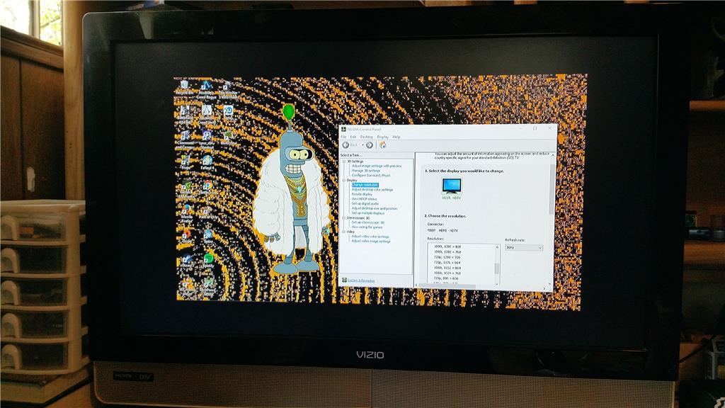

  3. JIMmfknBB Win User
    Native resolution not displaying properly.
    I just upgraded my nvidia drivers to the latest version, now there are big black margins around the edges of the screen when i use the native resolution. The native resolution is 1366 x 768; however the only resolution that fits my screen properly is 1768
    x 992, which makes text and icons appear small. I believe either windows or my graphics card are detecting my TVs resolution improperly. is there a way to adjust what my pc thinks the resolution of my screen is?
    Hardware: VIZIO VX37L (using HDMI), nVidia 960gtx, Windows 10
    The picture below is what the screen looks like using native resolution.
    Windows Not Detecting Native Resolution - Solution 75c46f49-a47a-48c8-857b-c6eb0bfbdef5.jpg
    JIMmfknBB, Feb 18, 2025
