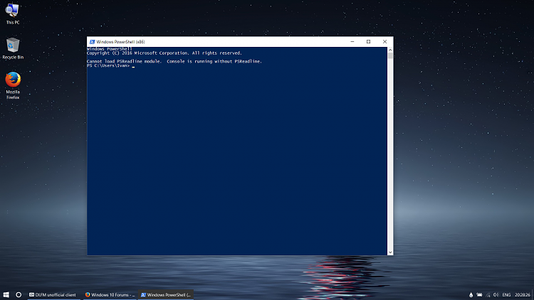

    Hello all,
    Can anyone tell me, please what is this error message in PowerShell (x86), why it has occured and how to fix it:
    ''Cannot load PSReadline module. Console is running without PSReadline.
    Thank you in advance...
    Windows PowerShell 7 "Cannot load PSReadLine module. Console is running without PSReadLine." 140685d1498156593t-what-psreadline-module-untitled.png
    Ivan Petrov, Jan 6, 2025
