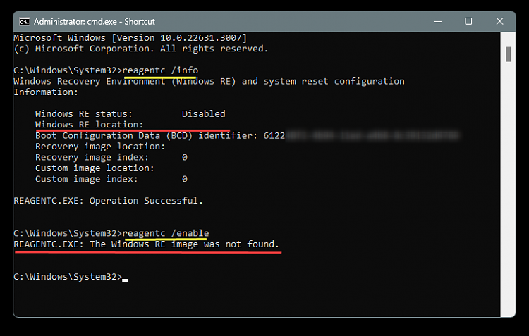

  4. Ghot Win User
    Windows Recent Update KB5034441 Error 0x80070643 code, Diskpart will not shrink WinRE by...
    KB5034441 0x80070643 error despite no WinRE volume
    I disabled, and removed the Recovery partition, and removed the Win RE parts as well. If you get these results (RED) from the commands shown (YELLOW), then you don't need the KB5034441 update. In my situation, there is nothing there for the hackers to... hack. Search your C:\ (Windows partition), for winre.wim [normally located in... C:\Windows\System32\Recovery] If it's not there, you probably don't need this update.
    Windows Recent Update KB5034441 Error 0x80070643 code, Diskpart will not shrink WinRE by... 403831d1705591861t-kb5034441-0x80070643-error-despite-no-winre-volume-image1.png
    If you use 3rd party backup software, you don't really need a Recovery partition. And even if you may need it for something... you can access it from the Windows install media. And... as @Hearsepilot mentioned, MS is claiming to have a fixed update ready by March-ish.
    Ghot, Feb 7, 2024
