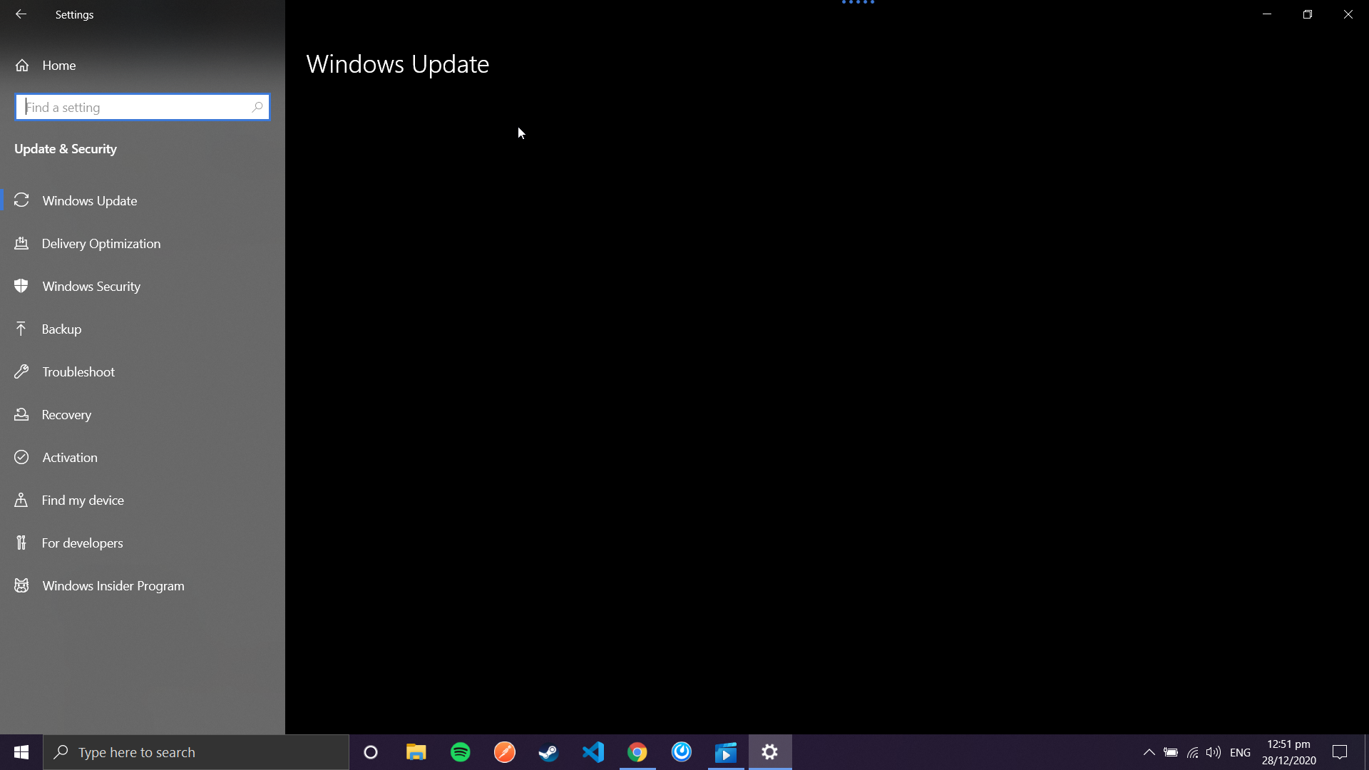

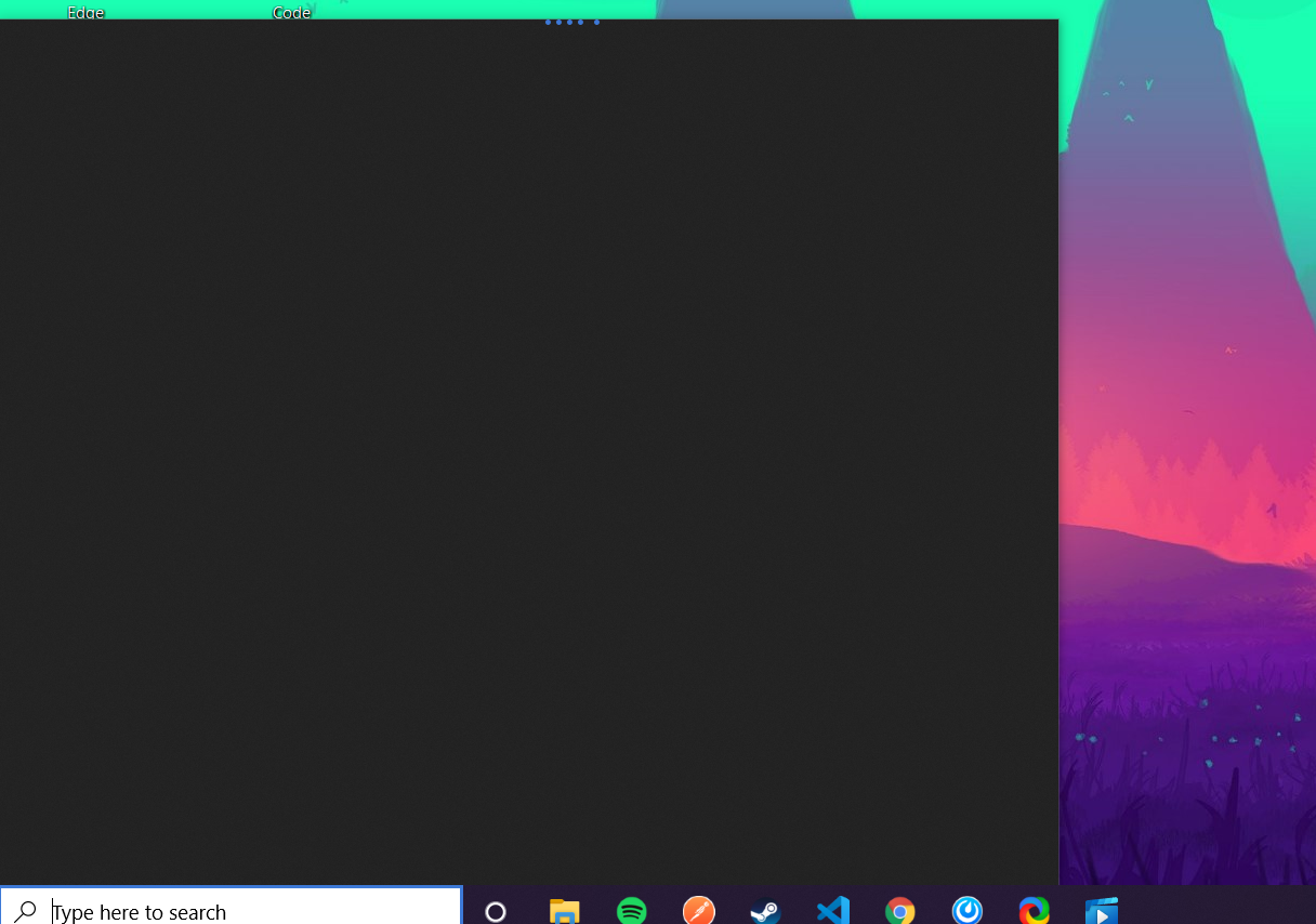

    Windows search and settings does not work keeps loading
    Currently having troubles with my window search and settings it does not work it just keep loading
    Anyone can help badly needed. I did try some fix from google like the regedit 'BingSearchEnabled' nothing happens.
    Windows search and settings does not work keeps loading 0af9a4dd-c685-4fc4-9a7b-f1901f77e898?upload=true.png
    Windows search and settings does not work keeps loading 528e837d-4669-4841-bfe2-bd5df6cecee5?upload=true.png
    Arman0008, Dec 28, 2020
  2. Start menu Search can't click on search results leading to Settings pages + Settings search results not loading
    Hello Abhishek,
    We regret the inconvenience and at the same time we appreciate the effort you have put in to resolve the issue. Let me assist you further.
    From the description provided, I understand that you are experiencing functionality issues with Windows in the following areas:
    • Search Results in the Settings pane do not work.
    • The Search results through Search Bar in Windows is unresponsive or sporadic when it comes to basic functionality.
    As an initial recommendation, I suggest you to try the Search and Indexing troubleshooter to fix the problem. It makes sure that the Windows Search service is running, and checks to see whether you have the correct permissions
    to search all the directories on your computer.
    Follow the steps given below to run Search and Indexing Troubleshooter.
    • 1. Type Troubleshooting in the Search box
      from the desktop.
      2. Select the Troubleshooting option.
      3. Select View All option and select the Search
      and Indexing
      4. Click on Next to perform the Search
      and follow the steps.
    Now, follow the below methods and check if it helps.
    Method 1
    If no corrupted system files were found in the previous state or were irrecoverable, then I suggest you to try the following steps to deploy the DISM command lines:
    • Press Windows key + X.
    • Click command prompt (Run as administrator).
    • In the Administrator: Command Prompt window, type the following commands. Press Enter key after each command:
      DISM.exe /Online /Cleanup-image /Scanhealth
      DISM.exe /Online /Cleanup-image /Restorehealth
      Important: When you run this command, DISM uses Windows Update to provide the files that are required to fix corruptions.
    • To close the Administrator: Command prompt window, type Exit, and then press Enter.
      Click
      here
      for more information about running the DISM Tool.
    Method 2
    Lets try to narrow down the issue, if the issue is at a specific user level.
    I suggest you to check if the same issue occur when logged in through a different Local Administrator user account.
    Follow the steps mentioned below:
    • Assuming that you are already logged on to your user account in Windows 10, click the Start button.
    • From the Start menu, click your name from the top of the left pane.
    • From the displayed options click Sign out.
    • From the login screen, click to the different user account you want to switch to.
    However, if you do not have a separate user account, I suggest you to create another Local administrator user account by referring to the Microsoft article here: Set
    up accounts
    Kindly keep us posted on the results for us to be able to assist you further.
    Thank You.
    Sayan_Ghosh, Dec 28, 2020

  4. Windows search and settings does not work keeps loading
    Windows 10: Settings search not working
    Hi Geoffs,
    As you are still facing an issue with Windows search, I suggest you to try the steps below and check if this helps.
    Restart Windows Search Service
    Try restarting Windows search service by following the steps below and check if it helps.
    1. Press Windows + R key, type services.msc and press
    enter.
    2. Right click Windows Search and stop the service.
    3. Right click again and start the service.
    4. Right click and select Properties
    5. Change the startup type to automatic
    and save the changes.
    I also suggest you to install the latest Windows updates and check.
    Windows Update helps keep your computer up to date with the latest system updates and drivers which can resolve the issue you are facing. You can check Windows Update manually to help ensure you have the latest updates.
    • Click on Start and select Settings.
    • Click on Update & Security.
    • Now click on Check for updates.
    Get back to us if you need further assistance.
    Thank You.
    ThofikhAhamad, Dec 28, 2020
