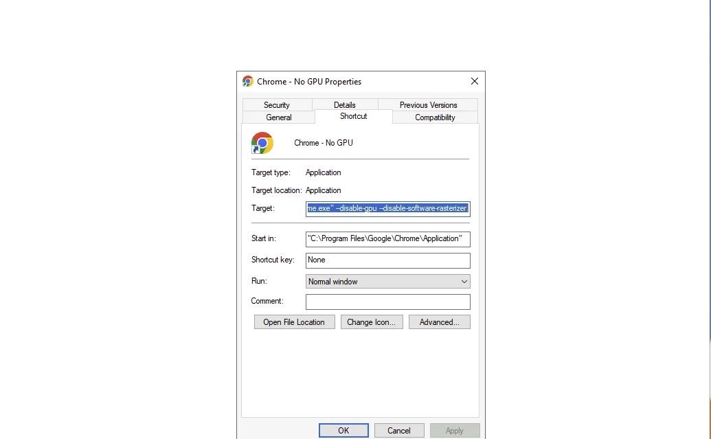

    In one example, a user explained that Edge consumed about 50% of CPU usage with 12 Edge processes and 8-10 Windows error reporting processes running. This issue also led to disk space filling up, but it only affected some of their terminal servers.
    Following the update, Chrome would open to a blank screen, and logging indicated a GPU load failure. Attempts to fix the issue, including updating VMWare Tools, trying the latest Chrome Beta, and reinstalling Chrome, were unsuccessful. The only solution was to remove the problematic update.
    According to a bug post on Mozilla forums, this bug also affects Firefox.
    In our tests, we discovered that removing the registry key “chrome.exe” found at HKEY_LOCAL_MACHINE\SOFTWARE\Microsoft\Windows NT\CurrentVersion\Image File Execution Options resolves the issue.
    Or you can open PowerShell and run the following command to delete the .exe:
    reg.exe delete "HKLM\SOFTWARE\Microsoft\Windows NT\CurrentVersion\Image File Execution Options\chrome.exe" /f
    You can also rename chrome.exe to something like chrome_test.exe, and Chrome will start working again.
    These steps do not require a reboot and work in most cases.

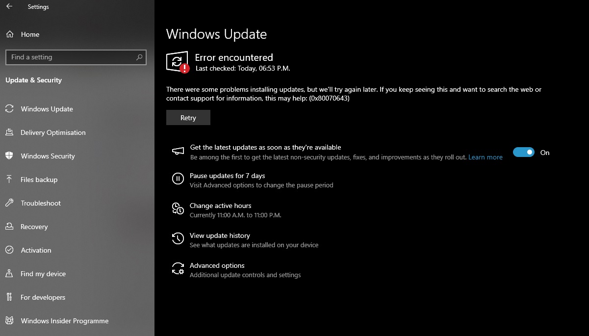

    Additionally, some of our readers are encountering installation issues with KB5034439 and KB5034129
    They reported error code 0x80070643 and problems when installing the security patch, even on newly built Server 2022 VMs from the official ISO. These VMs have a standard 200GB virtual HDD with a 573MB recovery partition, indicating that the issue is not related to imaging or a flawed base image.
    Windows Server 2022 KB5034129 crashes Edge, Chrome and Firefox with white screen Windows-10-0x80070643-error-with-KB5034441.jpg
    In our tests, we noticed that the issue is experienced when the system detects a recovery partition with low storage. You can fix it by increasing the partition size, or you can use the PowerShell script uploaded to our Discord server’s Windows 10 channel.
    Before running the script, you must download and install the Safe OS Dynamic Update from the Microsoft Update Catalog. Once done, run the PowerShell script, which applies the Safe OS update, and patches the installation errors by reconfiguring BitLocker.
