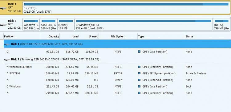

    I could not find the $Windows.~bt\ folder, I believe I did a clean files from system properties that deleted it. However, I did notice that I DO have IIS enabled (for .net development), which is the incompatibility link you posted. Here is an image from minitool, followed by the IIS programs I have enabled. I'm thinking I should try disabling those, and if I still get the error the dell instructions, and if that doesn't work, check my logs?

    Windows setup could not configure Windows to run on this computer's hardware. 172556d1515960887t-windows-setup-could-not-configure-windows-run-computers-minitoolexport.jpg
    Can I just disable the service (IIS Admin Service?), or do I need to remove these as recommended from add/remove windows feature area, then add them back?
    Thank again for the help, hope to figure this one out.
