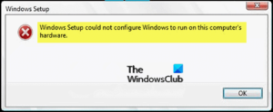

    Windows setup could not configure Windows to run on this computer’s hardware

    I keep getting "Windows setup could not configure to run on this computer's hardware" message at a bout 42% of the new windows update. How can I get this to work?

    Do you have any sort of unusual disk configuration e.g. RAID? (Ok, it's a laptop, but I've not checked its specs!)
    Dual or triple boot?
    Research suggests:
    - the hard disk being a 4K sector size and not a 512 byte sector size.
    error during Windows 7 or Windows 10 installation | Dell UK
    Older sources (pre Win 10):
    • In Notepad, click Open on the File menu, and then browse to %systemroot%\Panther.
      Note On a standard installation to drive C, the path is C:\Windows\Panther. (On most PCs this will be the C:\Panther folder)
    • Open the file setuperr.log, and look for lines that resemble these:
      2010-09-23 17:34:58, Error [0x0f0082] SYSPRP LaunchDll:Failure occurred while executing 'C:\Windows\System32\scecli.dll,SceSysPrep', returned error code 1208[gle=0x000003e5]
      2010-09-23 17:34:59, Error [0x060435] IBS Callback_Specialize: An error occurred while either deciding if we need to specialize or while specializing; dwRet = 0x4b8
      Note If these lines and errors exist, note the errors.
    • Open the setupact.log file that is located in the same directory, and then look for the line that resembles the following line:
      2010-09-23 17:31:26, Info SYSPRP SPPNP: iaStorV is the function driver for device PCI\VEN_8086&DEV_2822&SUBSYS_2819103C&REV_02\3&33FD14CA&0&FA
      Note If this line exists, it indicates that the drive on which you are trying to install Windows 7 or Windows Server 2008 R2 is configured in a RAID configuration.
