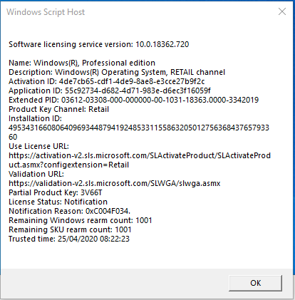

    A month or two ago, my Windows suddenly became non-activated for no apparent reason. I've tried reentering my product key to no avail.
    The key I've been using for years is one that I received from the old Microsoft Dreamspark program, but those keys should work indefinitely, should they not?
    I'd be grateful for any help.
    This is the output of slmgr.vbs /dlv
    Windows suddenly not activated; no hardware change d07006a7-8cf4-4992-8a2a-f0a1bb4ec886?upload=true.png
    JulianB4, Apr 25, 2020

  3. Nikhar_K Win User
    Unable to activate Windows after hardware change
    Usually the error code 0xC004F213 comes when there is a hardware change done on the computer (like Motherboard or Hard drive). The Windows license is associated with the device hardware. If there is any significant hardware changes, such as replacing
    motherboard or hard drive, Windows won’t be able to recognize the license.
    I suggest you to try the troubleshooting steps from the article
    Reactivating Windows 10 after a hardware change
    and see if Windows gets activated.
    If you are using an OEM computer that came with Windows 7, and the motherboard has not been changed, then you can follow the steps to retrieve the product key that came with your OEM computer. To retrieve the product key follow the steps mentioned
    below:
    1. Type Command prompt in the search bar, that is on the taskbar.
    2. Right click on Command prompt icon and select Run as administrator.
    3. Type the command and press on Enter: wmic path SoftwareLicensingService get OA3xOriginalProductKey
    4. You will find the product key.
    Hope it helps.
    Please reply with the status of the issue, we will be glad to help you further.
    Nikhar Khare
    Nikhar_K, Apr 25, 2020
