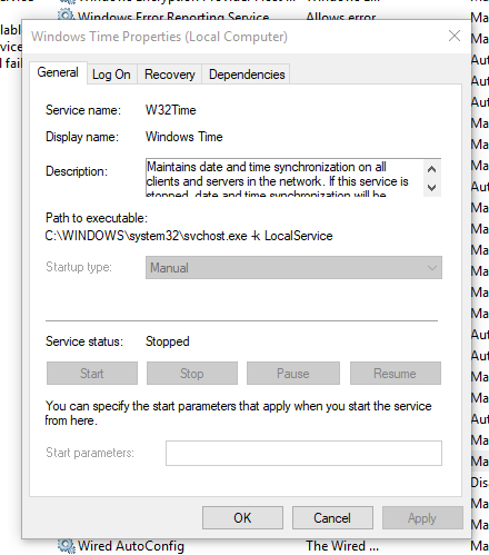

    Hi there! I'm experiencing a kind of weird and strict problem with windows time service!
    when I attempted to sync my system time with one of the servers, this error appeared: "Unable to start The windows time service. please try again later!"
    when I referred to Windows Time Service to fix the problem, I noticed that all items in all tabs are in gray condition and I cannot change nothing in there!
    I've tried many solutions so far, but the problem is so deep that when I try to re-register the Time Service, the Command Prompt says: Access is Denied error code 5 even though I'm on Administrator mode!
    any clue will be highly appreciated...
    Check out the screenshot Windows Time Service fully inaccessable! 0da0ecd8-adf0-4611-bb17-4793105786cd?upload=true.png
    hosseinseyyedrahman, May 27, 2020

  4. Windows Time Service fully inaccessable!
    unable to start the Windows time service on Windows 10
    Hi Enriq,
    As you are facing issue with starting the Windows Time Service, do not worry we will help you with this issue.
    Do let us know the following to assist you better with this issue:
    • What exactly happens when you try to turn on the service?
    • What is the complete error message/ error code of this issue?
    • Have you made any changes to the operating system prior to this issue?
    Method 1: I suggest you to run a SFC scan and check if it helps.
    System File Checkeris a utility in Windows that allows users to scan for corruptions in Windows system files and restore corrupted files.
    Follow the below steps:
    • Right click on the Start button, click on
      Command Prompt (Admin).
    • Type “sfc /scannow” without the quotes and hit
      Enter.
    • After the scan, restart the computer and check for the issue.
    Note: If you are not able to repair some files after performing SFC scan, I suggest you to refer to the point 3 “Windows Resource Protection found corrupt files but was unable to
    fix some of them. Details are included in the CBS.Log %WinDir%\Logs\CBS\CBS.log”. Under the section “Run the System File Checker tool (SFC.exe)” to repair the corrupted files after performing SFC scan.
    Refer: Use the System File Checker tool to repair missing or corrupted system files
    Method 2: I suggest you to Restart Windows Time Service and check if it helps.
    Windows Time Service maintains date and time synchronization on all clients and servers in the network. If this service is stopped date and time synchronization will be unavailable. If this service is disabled,
    any services that explicitly depends on it will fail to start.
    Step 1: Stop the service:
    • Press Windows Key + R on the keyboard and type
      services.msc, Services window gets opened.
    • Search for Windows Time service and stop.
    • To do so, right click on each service select Stop
    • Restart the device.
    Step 2: Start the service and set it to automatic:
      services.msc
    • Search for Windows Time service, right click on it and click on
      Properties.
    • Start the service, set
      Startup type to Automatic.
    Hope it helps. Kindly update the status of accessing the Windows Time Service for further assistance.
    Deepika Gowda, May 27, 2020
