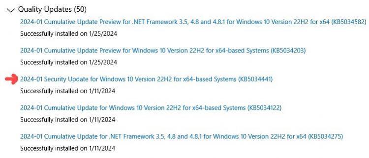

    KB5034441 Security Update for Windows 10 (21H2 and 22H2) - Jan. 9

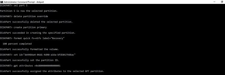

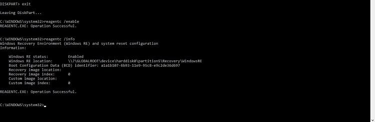

    Windows Update 22H2 reboots computer when "working on updates" reaches 9% 404299d1706148426t-kb5034441-security-update-windows-10-21h2-22h2-jan-9-a-dp1.jpg
    Windows Update 22H2 reboots computer when "working on updates" reaches 9% 404300d1706148450t-kb5034441-security-update-windows-10-21h2-22h2-jan-9-a-dp2.jpg
    I performed Windows Update again yesterday, and everything seems to be good.
    Windows Update 22H2 reboots computer when "working on updates" reaches 9% 404302d1706148582t-kb5034441-security-update-windows-10-21h2-22h2-jan-9-a-dp3.jpg

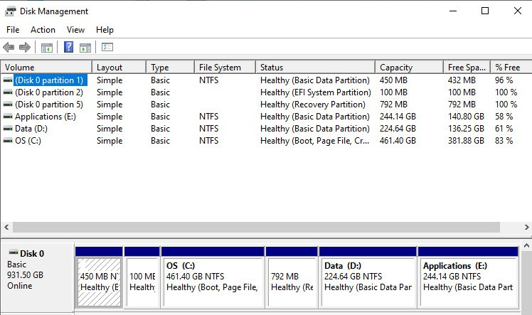

    However, when I checked disk management, the recovery partition was empty (100% free space).
    Windows Update 22H2 reboots computer when "working on updates" reaches 9% 404303d1706148721t-kb5034441-security-update-windows-10-21h2-22h2-jan-9-a-dp4.jpg
    My question is: where was KB5034441 installed? And why does partition 1 (450MB) have 96% free space? What is 4%? Thank you very much for your help *Smile
