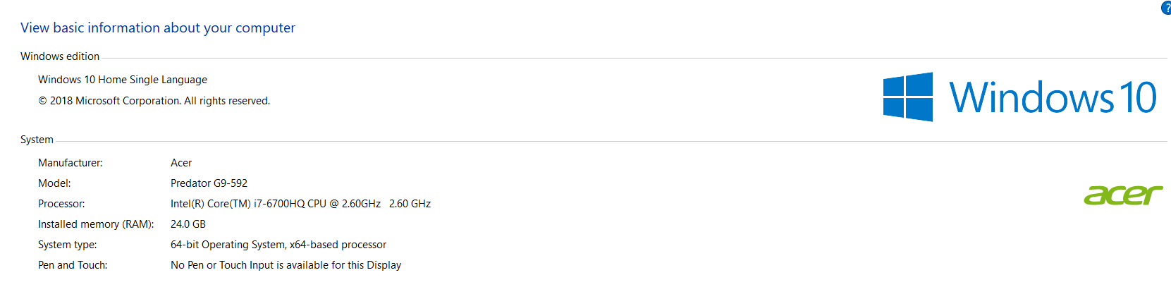

    I have the Gaming Laptop Acer predator 15, here are the specs:
    Windows Update kb4551762 and Random HDMI Monitor Flicker a17cd475-a5e8-4a86-8c91-2cd3ed48721b?upload=true.png
    My issue is that when ever i connect my laptop to a monitor the screen flickers every few seconds or more often when I start a video, for example if I open a new video on YouTube, as soon as the video has loaded the screen flickerers
    Laptop - (Acer Predator 15)
    i7-6700HQ Quad Core Processor 2.6GHz with Turbo Boost Technology up to 3.5GHz
    15.6" Full HD (1920 x 1080)
    NVIDIA GeForce GTX 1060 with 6 GB of dedicated GDDR5 VRAM
    Monitor - (HP Monitor 22es)
    1920 x 1080 - 21.5" IPS Display with max 60Hz refresh rate
    HDMI and VGA Port
    My issue is that when ever i connect my laptop to a monitor i bought recently the screen flickers every few seconds or more often when i start a video, for example if i open a new video on YouTube, as soon as the video
    has loaded the screen 2 to 3 times before the video starts. The HDMI Cable i use is the one that was included with the monitor, i am running everything at it's native resolution and refresh rate. I have tried using a HDMI to VGA port, to connect via VGA and
    the flickering is taken away but the quality is also reduced, i am a content creator so quality for me is important.
    Any suggestions i should try?
    AhmadNaveed, Mar 25, 2020
