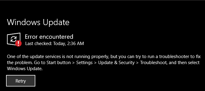

    My windows update is not working.
    It said: "Error encountered. One of the update services is not running properly, but you can try to run a troubleshooter to fix the problem. Go to Start button > Settings > Update & Security > Troubleshoot, and then select Windows Update."
    Windows Update: One of the update services is not running properly, troubleshooter doesn't... ff93ca0a-ffc7-462c-bfb9-9b601f0382c3?upload=true.png

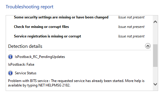

    I've tried running the troubleshooter but it didn't fix the problem.
    Windows Update: One of the update services is not running properly, troubleshooter doesn't... 21d2eb97-4b38-4b1f-b7d6-ab22b310656b?upload=true.png

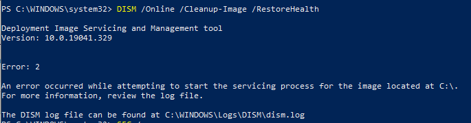

    Trying to fix the problem with DISM, also failed due to error 2.
