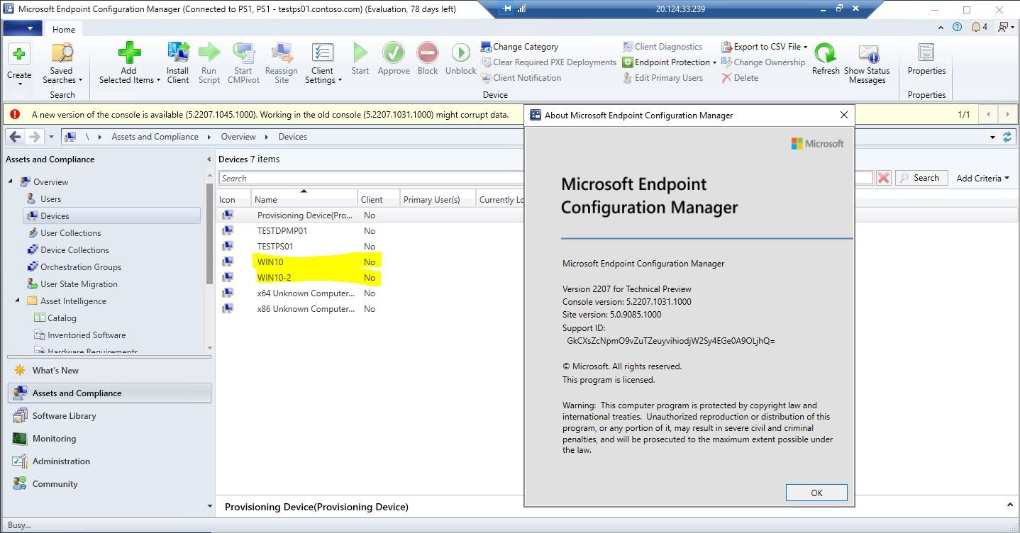

    i configured SCCM server on Azure VM and looks like all the settings configured but for some reason i still dont see the client installed from the SCCM dashboard although on the client side the client installed and found the MP.
    Windows Upgrade failures from SCCM deployment ac63bfa0-9c66-4038-a661-86fa51dd4afd?upload=true.jpg
