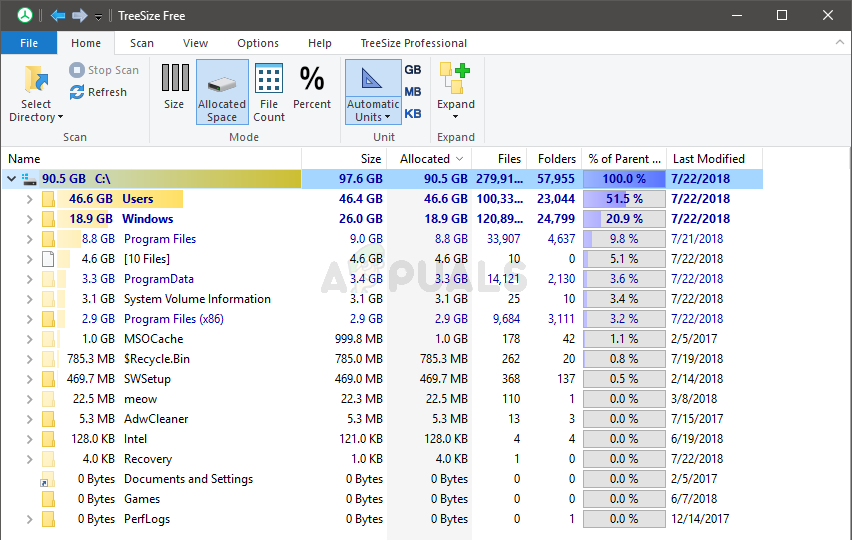

    Method 1: Use TreeSize
    TreeSize is a third party application that can help you get the correct sizes of your files and drives. It is a graphical manager for hard drive space. This tool comes with a free trial as well so you don’t
    have to spend anything on it. The free trial should be more than enough for you.
    1. Click here and select the appropriate region
    2. Click Next
    3. Run the setup file once it is downloaded
    4. Everything should be self-explanatory. Simply install the software
    5. Once installed, open TreeSize
    6. You should see a File Explorer like window. It will automatically scan your drive and show you the folder sizes.
    WindowsApps Folder contains files with wrong size information leading to wrong free space... 1-36.png

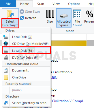

    1. If you want to look at other drives then click Select Directory and select your desired drive
    WindowsApps Folder contains files with wrong size information leading to wrong free space... 2-8.png
    1. TreeSize will automatically scan the selected drive as well
