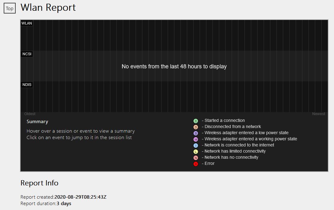

    I use an administrator cmd netsh wlan show wlanreport to generate a Wlan Report.
    However, the report shows "No events ..." ... attached.
    I connect to my wireless modem every day, and shutdown my computer when not in use.
    Please advise, thanks!
    Windows 10 Pro version 1909 build 18363.1016
    Wlan Report - No Events 003ca94a-77fd-4257-b60b-4258dab317f5?upload=true.jpg

    I see everything that is in that report in there. Have you tried opening it up on another machine? There are items in that report that are contained in C:/ProgramData/Microsoft/Windows/WlanReport/wlan-report-latest.html. That directory contains all wlan reports.
    bro67, Aug 29, 2020
