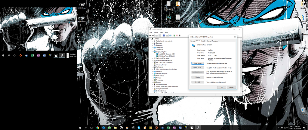

    I have tried to update the driver to the latest version(375.70), install previous versions (which used to work) and completely removing any traces of my Geforce 650M gpu and both installing the latest version and doing the same steps with a previous version.
    The card is enabled and visible in the Device Manager and is indeed at the version I had installed.
    The Nvidia control panel Says : "NVIDIA Display are not available. You are not currently using a display attached to an NVIDIA GPU". However when I plug in an HDMI device (in this case a tv used as a monitor), I can access the nvidia control panel. But for
    all other purposes the GPU does not work. My computer is an ASUS N76VZ. Sometimes there also seems to be a display which does not exist.
    You are not currently using a display attached to an NVIDIA GPU Error message [HELP] [​IMG]
    You are not currently using a display attached to an NVIDIA GPU Error message [HELP] 9a1a9f43-ff32-4068-856a-f8c47c218531.png
    Thought I should also mention that only my Intel(r) HD Graphics 4000 is displayed in dxdiag
    DJoEisDJoE, Oct 20, 2024
