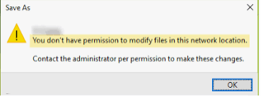

    Hello,I have rather troubling issue, banging my head for over few weeks now. I will try to be as much detailed in my explanation of the issue. There are number of users in different environments some are using Azure AD joined devices profiles, some domain joined profiles, some are local profiles. They all have issue when saving pdf/office documents from Chrome/Edge/Outlook to Desktop/Documents folders. All get the same error message: "You do not have permission to modify files in this network location. Contact the administrator per permission to make this changes". So if user clicks at first

    I have rather troubling issue, banging my head for over few weeks now. I will try to be as much detailed in my explanation of the issue. There are number of users in different environments (some are using Azure AD joined devices profiles, some domain joined profiles, some are local profiles). They all have issue when saving pdf/office documents from Chrome/Edge/Outlook to Desktop/Documents folders. All get the same error message: "You do not have permission to modify files in this network location. Contact the administrator per permission to make this changes". So if user clicks at first "OK", it kind off saves file with 0Kb to the location, and then if user tries saving again, it will save and overwrite file that is 0Kb with new file that is ok and can be opened and has normal size. Also in Event viewer it generates this message:

    "You do not have permission to modify files in this network location." multiple users,... 1962ef6a-ea19-42c9-af86-6e073e438426?upload=true.png

  3. Unable to save files correctly to network share with read & write permission
    Saving any file to network share folder brings up an error message:
    z:\test2.xlsx
    "You don’t have permission to modify files in this network location.
    Contact the administrator per permission to make these changes"
