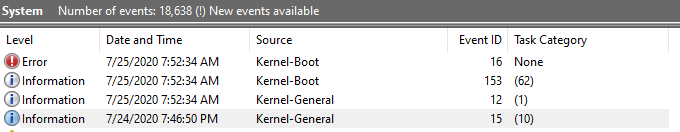

    My PC reboots when being reactivated from hibernation resulting in the loss of the previous session. It exhibits the problem whether scheduling or manually executing the hibernate function. It was working prior to the May update.
    Typical log entries
    0xc0000411 error using hibernate eeafe719-4277-480a-9910-8e641062e809?upload=true.png
    Hibernation was activated on the PC at ~10pm on the 24th and reactivated at 7:52:34 on the 25th. Also at 7:52:45 log error 6008, The previous system shutdown at 9:07:56 PM on 7/24/2020 was unexpected, shows up. The interesting thing is the lack of log entries from the time I hibernated the PC and when I tried to reactivate the PC. Seems to suggest the PC was hibernating and failed in the reactivation process.
    I've tried some of the suggested fixes from the Internet, they don't work. Most of the traffic on the Internet are for versions of Windows prior to 2020. May not be an issue for most, but any help with troubleshooting would be appreciated.
