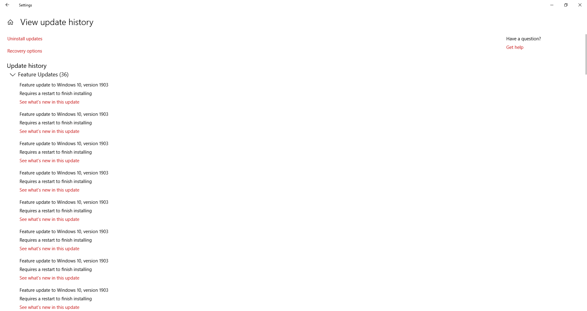

    1803 can't update to 1903 windows 10 FAILED TO INSTALL
    im currently updating my windows from os build 1803 to Feature Update to Windows 10, 1903.
    its take so many time, i have doing this for 7 days and already 40 of Feature update right now. i dont know when will this update going, and im really frustated cause taking my time for updating & restart.
    i have tried windows update assistant, but failed on installing.
    1803 can't update to 1903 windows 10 FAILED TO INSTALL df725eb7-5489-4e56-bb2a-6c8ca7e20d60?upload=true.png
    i have tried windows update assistant and doesnt work at all with message "windows failed to install" .
    i have tried to manual download by using windows media creation tool ---> upgrade this pc.
    all the download and install progress looking good until finish and computer will restarting in few minute this message "windows failed to install" appear. what should i do
    1803 can't update to 1903 windows 10 FAILED TO INSTALL 48c290d1-edd2-432f-9fa7-d14488cc2066?upload=true.png
    firekoros, Oct 27, 2019
