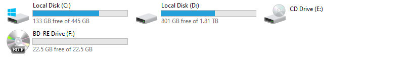

    Nothing is showing up in the My PC list.
    2 USB 3.0 ports Working, but not working. [NEED HELP] [​IMG]
    They clearly work when plugged in. Those are the blue lights showing the USB 3.0 is working, but NOTHING plugged into the ports show up on my PC or are actually "enabled". They show up on device manger perfectly but dont actually function. I am at a loss.
