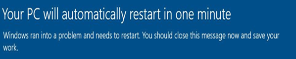

    since 05.07.2020 my Laptop HP Pavilion always reboots with the following message:
    A critical system process, C:\WINDOWS\system32\lsass.exe, failed with status code c0000374.... ce3c97d6-ee5f-4903-85c2-dae747cf70ef?upload=true.png
    Sometimes the user cant login and there is only the login button and nothing else is possible.
    Sometimes there is the messsage "Error while login with service local session manager". RPC Server is not availible.
    I think the error with the RPC Server is just a result of the real error.

    The windows event log says the following:
    A critical system process, C:\Windows\system32\lsass.exe, failed with status code 1073741819

    Remote desktop causing "Your PC will automatically restart in 1 minute"
    This happened to me as well; also, I noticed a unique error in the Event Viewer just before the computer crashed:
    "A critical system process, C:\Windows\system32\lsass.exe, failed with status code c0000409. The machine must now be restarted." (also error code c0000374)
    I was worried my computer was failing, and started running memtest and sfc /scannow, but in the end adding a password to the remote Windows 10 computer was all it took to fix the problem.
