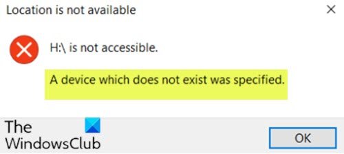

    If when you try to open a disk in File Explorer, or you open Disk Management tool on your Windows 10 device, to initialize a disk, but you encounter the error message A device which does not exist was specified, then this post will help you.
    A device which does not exist was specified – Disk error on Windows 10 A-device-which-does-not-exist-was-specified.jpg
    When you encounter this issue, you’ll receive the following full error message;
    Location is not available
    <DriveLetter>:\ is not accessible.
    A device which does not exist was specified.
    Affected PC users may also notice that in Device Manager, the problematic disk is listed as Unknown Disk, but it still works correctly when you click on the properties.
