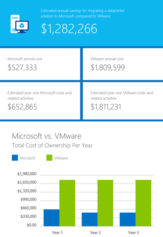

    Announcing the new VMware migration offer for Windows Server 2016
    Source: Announcing the new VMware migration offer for Windows Server 2016 | Windows Server Blog
