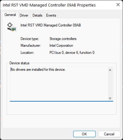

    I recently purchased a new DELL Alienware Aurora R13 computer (Windows 11 Home) and ran the Performance Monitor just to status it. I got the following error:
    [table][tr][td][table][tr][td]The device, Intel RST VMD Managed Controller 09AB, is reporting a bad status value. This device will not be available until the issue is resolved. The Plug and Play ID for this device is PCI\VEN_8086&DEV_09AB&SUBSYS_00000000&REV_00\3&11583659&0&30.[/td][/tr][/table]
    [/td][/tr][/table]
    Over in the device manager, Storage Controllers, Intel RST VMD Managed Controller 09AB Properties, the device status is listed as:
    "No drivers are installed for this device."
    ABOUT A CORRUPT DEVICE: Intel RST VMD Managed Controller 09AB fe171d0d-c566-4bbe-a26e-4164cf196ecf?upload=true.png

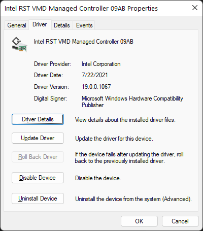

    But, if you check the driver tab, you can see that the device is installed:
    ABOUT A CORRUPT DEVICE: Intel RST VMD Managed Controller 09AB 60558155-b009-4540-b256-1839fa6505a3?upload=true.png
    I checked with the Alienware support team and they are convinced that there's nothing wrong and that this is a bug in Windows. They say the correct driver is installed (there is no updated driver, either).
    The bug, according to them, is that the device is incorrectly reporting a bad status (indicating that the device is not there), when in fact it should be reporting:
    "The device is working properly."
    Has anyone else seen this and/or is this a known problem in Windows 11? Even though the device appears to be working just fine, I want to make sure that this is indeed the correct driver for this controller.
    frank479, Nov 23, 2022
  3. Performance Monitor: A device has reported a 'Not OK' status (Intel RST VMD Managed Controller 09AB)
    Do you have the Intel Rapid Storage Technology app installed on your PC?
    If you install/open it, does it function correctly?
    Also, do you have Alienware Update installed and have you run it to ensure you have the latest driver/firmware/BIOS updates? (you can find the downloads for it here: https://www.dell.com/support/kbdoc/en-ca/000187189/dell-update-alienware-update)
    If Intel RST itself is working fine, and you're up to date, then I'd say the Dell/Alienware tech support is probably right.
    Brian Burleigh, Nov 23, 2022
  4. frank479 Win User
    They installed the Intel RST driver and app with me and it appears to be functioning correctly.
    Yes, I have version 4.3.0 of Alienware Update installed and I also have their DELL Support Assist and it appears to do the same thing ensuring that I have the latest drivers/BIOS updates, etc. Everything is currently up-to-date.
    Thanks for the info and at this point I'm hoping someone from the Windows Development Team sees this.
