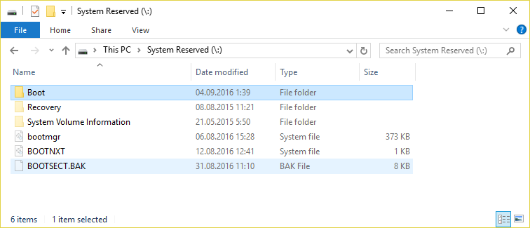

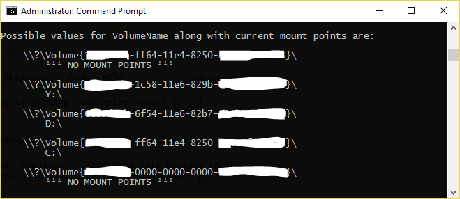

    I have found more straightforward way of getting read/write access to EFI partition from Windows 10:
    1. Open an Administrator Command Prompt window by right-clicking Start button and clicking on Command Prompt (Admin)
    2. In the Command Prompt window, type mountvol, disregard help message in the beginning and notice the list of GUID-based paths of all volumes known to Windows, eg.:
    1. GUID of EFI partition is one of those marked with "NO MOUNT POINT" description - in my case it was the first volume
    2. type start \\?\Volume{.......-....-....-....-...........}\ (of course replace dots with the exact GUID from step #3) and new explorer window will pop up with the contents of EFI partition and read/write access to it - voila!
