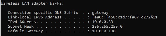

    Hey Guys
    I am trying to access my router using file explorer
    Access USB Plugged into Router c9f1cae7-e0d8-41ef-ae07-ef99aa287876?upload=true.jpg
    I then used the default gateway address and tried pasting it into file explorer as shown
    Access USB Plugged into Router 496b9c8c-27f8-4311-babb-e9493b5127e4?upload=true.jpg

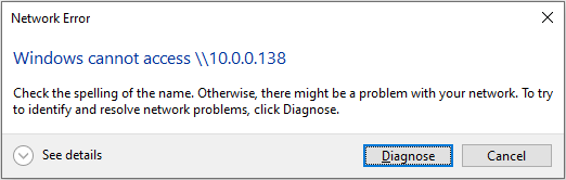

    But then receive the following error
    Access USB Plugged into Router 50c4d3d6-7b5b-470e-aef8-ac803c8c7e79?upload=true.png

    In case the above steps won't work, then you may have to access the USB drive using the router's IP address. If you don't know the router's IP, then you can check it from the
    Command Prompt. Just type in cmd in the Cortana search, then press Enter. Once the command prompt window opens, type in
    ipconfig, and press Enter. Whatever Default Gateway appears on the result is your

    To access the USB drive using the router's IP, follow these steps:
    1. Open the File Explorer.
    2. Click the Network Folder, then clear the path in File Explorer, and replace it with
      \\192.168.2.1 (or whatever router IP you have), then press
      Enter.
    Access USB Plugged into Router 689e83b8-12c2-4ed2-a7f0-f834044f8cdf?upload=true.png
    3. The USB drive should now show as a shared folder. At this point, you can either
    pin the shared folder to Start, create a shortcut to the desktop, or
    map it as a network drive. You may follow the same steps from the link I provided above.
    Please let me know how it goes so I can further assist you.
