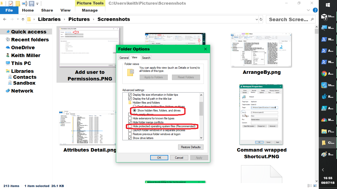

  3. Accidentally merged desktop folder with user
    You can untangle this without a restore. I think what you're seeing is that you accidentally moved the Desktop folder to your User folder. Now what was your Username folder is showing as 'Desktop' with the Desktop icon. You can clear the renaming & icon
    by deleting the Desktop.ini file in that folder. The file will have it's Hidden & System attributes set, so you have to set Explorer's view options to Show hidden files as well as clear the checkbox for Hide protected operating system files.
    Accidental merge of desktop folder with User folder f4876568-8581-4a35-95aa-280180f294c5?upload=true.png
    Then you can create a Desktop folder wherever you like & edit the path for Desktop in the User Shell Folder key mentioned in an earlier post.
    Keith
    Keith A. Miller, Nov 4, 2022
