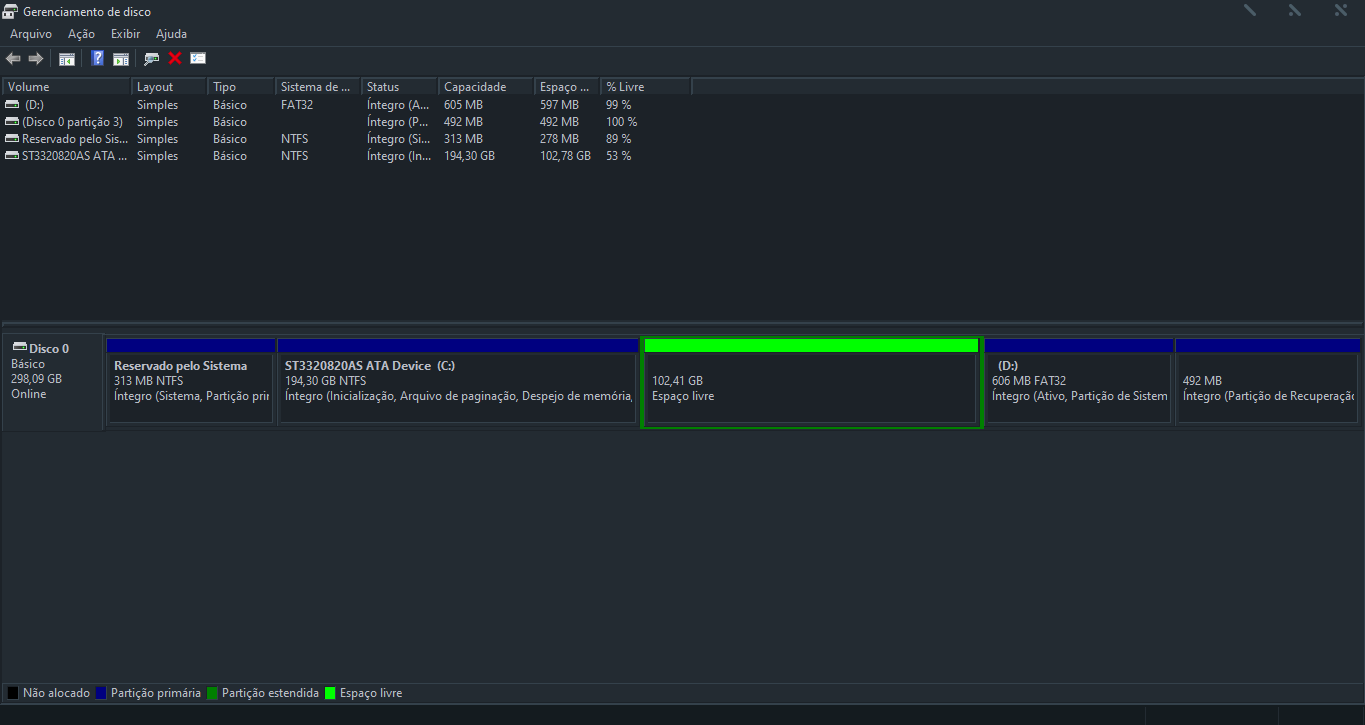

    I dual boot Windows 10 and Linux Mint, and there was a D:/ partition I wanted to delete, so I selected it and clicked "Delete volume", but 3 other partitions disappeared I think they were selected too, I don't know how though and now I have 102,41gb of free space, how do I undo these changes or recover it? I didn't mean to delete 3 partitions, and I didn't know they were selected. I didn't restart my computer yet because I'm assuming if I restart my PC I won't be able to recover my partitions anymore because the "changes" will be "applied". Please help! Here's how my screen looks
    By the way, D: is my EFI partition from Linux, I don't know if this helps.
    Edit: I have already searched this and I don't know what to do, the answers tell to recreate the partition but I don't remember the size because there were 3 partitions Accidentally deleted 3 partitions, how to recover them? ed9b4da4-a56e-43b4-b9c0-6ea9f60046b4?upload=true.png

    Yeah,deleting a partition dosen't mean that this partition is gone for good.Only the partition table is deleted and you can recover deleted partiion with partition recovery software.I had succeed to do so before.

    Try this, it works... it is open source...
    TestDisk, Data Recovery
    Quote from site:
